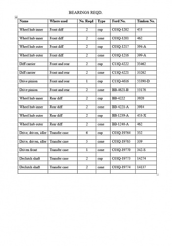

Jock Reed wrote:
Here is a list I compiled from the Maintenance Manual of the various drive train bearings used in a Ford CMP. It may be of use to anyone who doesn't have the Manual or Parts List.
Note: Timken numbers are considered the standard industry reference number. That number will always be cross-referenced to other bearing manufacturers' numbers.

Re. reference numbers, there is something called the International Bearing Interchange guide, so it’s not a Timken standard but an international one.
Here’s some info on how the designation system works: https://www.skf.com/au/products/roll...gnation-system

Thanks Hanno,
Point taken. I guess I should have called Timken numbers a de-facto standard as so many suppliers refer to that number to find their equivalent.
I never had any problem sourcing any bearings no matter who the manufacturer when quoting a Timken number.
Has anyone ever found an equivalent for the steering end pivot pin bearings?
That request has come up a few times on websites. Listed as N.D. 928 (New Departure?)
Likewise Drive pinion pilot bearing Bower BS 13000-B.
In both cases I was able to obtain NOS ones but it could come in handy for others to know.
