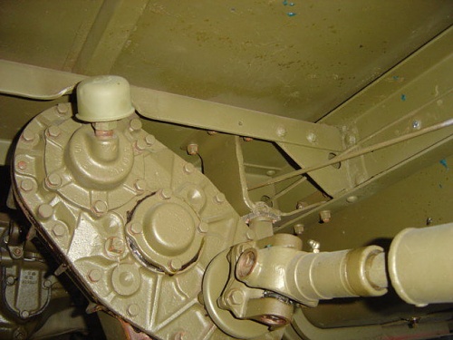

Hi Guys,
Does anyone know where I can get a better looking Transfer case vent from, for my Chevrolet c15a no. 12 cab.
LDW doesn't have anything.
Paul

Thanks Richard I'll try your source but before doing so and whilst searching the internet I came across these two photos of what appears to be images of transfer case but the vent differs, is there any reasoning behind this?
I then went on to look at my butchered vent which might suggest it was squashed to enable it to be fitted below the chassis cross member.
Any experts out there that might shed light. I'm thinking I may have the wrong vent.

A. It would be presumptuous for me to claim to be an expert
B. I suspect the simpler vent (a loose fitting cap pinned onto the vent tube) was a case of simplify to cut production time and cost while maintaining most (some?) of the dirt protection capacity of the damaged version you have
C. It is possible to use the vent caps sold for Chevrolet 235 CID valve covers to fabricate a passable replacement for the damaged transfer case vent. My process is: uncrimp the perimeter of the damaged dome to remove the perforated flat panel (and the filter medium if possible), braze/weld/solder the recovered flat panel to the recovered (or a new replacement) pipe that threads into the transfer case, reinstall the filter medium into the dome and crimp the edge onto the flat disc. If the filter medium isn't recoverable, consider usiing metal mesh from a pot scrubber (also sold as pest control https://www.leevalley.com/en-ca/shop...copper-blocker).
1 Transfer vent.jpg   2 copper mesh.jpg   3 transfer vent.jpg   4 transfer vent.jpg   5 transfer vent.jpg
Old 22-11-22, 15:26
Posts: 2,321
More images to show how the pipe core was facricated . Basically off the shelf black iron pipe nipple, cut in half to give two pre-threaded stubs, turned down slightly to let a drilled out nut be slid onto the pipe, brazed together then the disc drilled/cut/filed from flat sheet added.

There were two different vents used.
Please see attached GM Service Information Bulletin B29, Item 64 from December 12,1942
The early one was simply a pipe with a cap on it held on by a cotter pin "Fig2". The second version was the air cleaner type "Fig2".
These were introduced into production starting at serial number 1844332070.

GRANT! BRILLIANT!
Took the opportunity to photograph my own tranny today, it appears to be the early version (pipe/cap/cotter pin fig2) type, the vent exits vertically, hence why the air cleaner type had been butchered to fit under the cross rail. The air cleaner one would appear to exit at 45 degree slant.
Am I reading this bulletin correct, ie: the air cleaner type superseded the simple pipe/cap/cotter pin fig 2 type?
If so and all I need is the simple version then I recall there's one of these vents on the Jeep tranny, I wonder whether this wound fit?
Paul

I sounds like the air cleaner type was a product improvement, and that is was to be retrofitted onto the earlier transfer cases to replace the simple tube and cap. But in all seriousness, for the miles any of us will put onto our vehicles, nor the dirt we will subject them to, the nipple and cap would likely be fine.
If you are talking about the little nipple and cap on the jeep transfer cases, they are normally spring loaded onto a little check valve which will build up pressure to about 3 or 4 psi before reliving the pressure. They are usually 1/8 npt thread so would be pretty small for this application. However, with some bushings, it would work fine. The same nipple was used on the M35 deuce (and a thousand other vehicles) for that large transfer case for the last 60 years.
Edited to add: I had to look up the early Jeep transfer case breather and just saw that some indeed are a nipple with small cap retained b a cotter pin. But some sources are showing the pressurized cap which is more what I am used to. Someone with a WW2 Jeep will have to confirm if the nipple and cap type is 1/8 NPT.

The Jeep uses a similar vent on the transfer case. It looks like one of those would work just fine.

Thank you guys for all your assistance, in the end I took the path with lest resistance.
Giving my transfer case is the early type with the vertical nipple and cap breather and whilst accepting the modification bulletin to fit the air cleaner type, it is clear why my squashed cap had been butchered to fit the tight space available. Latter breather housings were to have a new casing exiting at 45 degrees to overcome this issue.
So with the original pipe nipple and my plumbing skills I made a cap from 22mm copper pipe and a feed end cap, once painted no one will Know.

You'll just have to remember that if you drive into water that is above that level you will need to change the oil in the transfer case. Mind you, I guess the other cap doesn't prevent water from coming in either. So the only minor negative is that the normal breathing of the transfer case as it heats and cools will allow unfiltered air into the gearbox. So if you go driving through the desert,, or long gravel roads, you will want to change the transfer case oil more often.
In the real world of a restored cmp, I would say there is no negative to the modification you have done.
