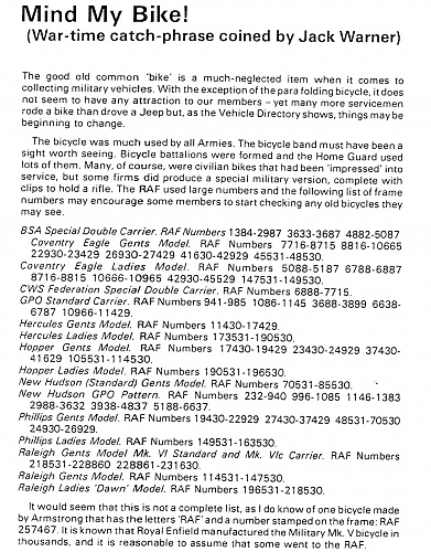

From an early MVCG/MVT magazine, via Rob van Meel. A list of bicycle frame numbers used by the RAF include a listing for Hercules Gents Model: RAF numbers 11430 - 17429.

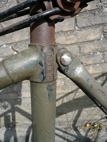

First time I see a reference to Hercules frame numbers, mine has frame number CB 9526.
