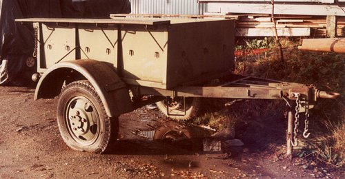

Old 21-01-07, 02:23
Senior Member
Location: Norway
Posts: 329
Default Mine
This is mine..
Rolf
http://www.surfacezero.com/g503/data...edusert3gp.jpg

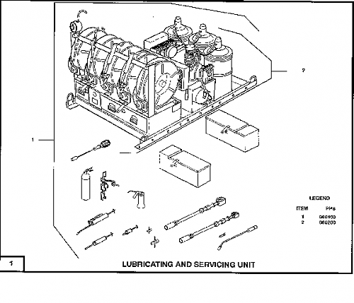

Took me a few minutes to figure out how to copy it from it's format to something I could post here, but hopefully here it is. Here is the present day lube unit, or at least as it existed in 2002.

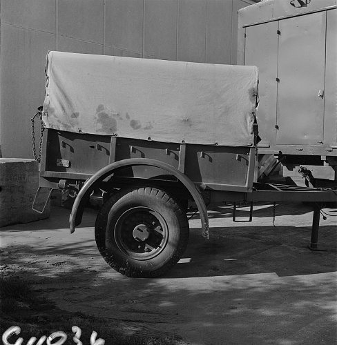

Who would have thought these trailers migrated all the way down to New Zealand? It served for a long time - maybe it's stil there...
Caption: "Side view of a covered trailer. RNZAF Base Whenuapai."

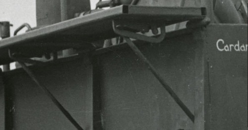

Old 17-09-21, 16:58
Posts: 2,323
Thank you Hanno,
The photo above is the clearest picture I have ever seen of the mechanism used to support the folding sides of the CMP 15 cwt trailer. When you were researching the servicing trailer, did you notice any other photos showing the support rods and mechanism?
Old 19-09-21, 10:21
Posts: 14,930
Hello Grant,
There are not many pictures or other details available of this type of trailer, let alone clear ones like the one in the Dutch Defense image bank.
The mechanism seems to be a J-shape track that guides a stay to keep the sides at 90-deg. or vertical.
Maybe Rolf still has his trailer and could share some detail pics?
Old 19-09-21, 12:37
Posts: 2,323
Thank you. I agree with what you say, with additions: The J tracks have two positions to hold the sides (called flare boards in the AEDB record - I've no idea whether this indicates they are always flared or if they get up to vertical) horizontal and at an intermediate position before reaching vertical (or nearly so). The support rods look like they are probably round (makes sense as they would be equally likely to buckle in any direction under an axial load) I have no idea whether tube or solid bar. Tube would be lighter for the same strength, but weight never seems to have been a worry in CMP construction. There appear to be flat sections at the end of the supports for pivots to pass through. On the remains of the original body work on my trailer, the lower pivots are threaded and drilled for a cotter pin (the sides must have been removed a long time ago as all of the holes are clear - no rusted remains of cotter pins in any hole). In your photos, the upper ends of the rod appear to have a cross pin (not sure if bent or welded on) that must be threaded as there look to be wing nuts to keep it in place in the J slots.
That's about all I can draw from the pictures, I may have to make a mock-up to try to figure out the geometry of the bars and J slots. On first appearances, I'm not sure whether a straight bar with the cross pivots on its centerline would clear the reinforcements at the join between body and flare board if the flare board is truly vertical - another reason to make tha mock-up.
The pictures in the manual for the trailer are much lower quality than what you provided but they do all seem to generally agree.
Old 19-09-21, 13:17
Posts: 565
The two left hand photos in post #10 show the sides at about 45 degrees and with a tilt fitted over them. That must be with the stays hooked into the intermediate position, with the two extremes giving horizontal and vertical. I think that the bars would clear the top rail of the fixed sides as the J slots are some distance out from the outside face of the flare board.

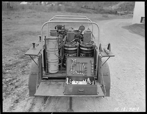

Old 07-12-23, 12:14
Posts: 14,930
Nice detail view of the contents of the Workshop Servicing Trailer:
"Trailer"
RCAF photo, no location, date 10 Apr. 1942.
Source: http://central.bac-lac.gc.ca/.redire...82093&lang=eng

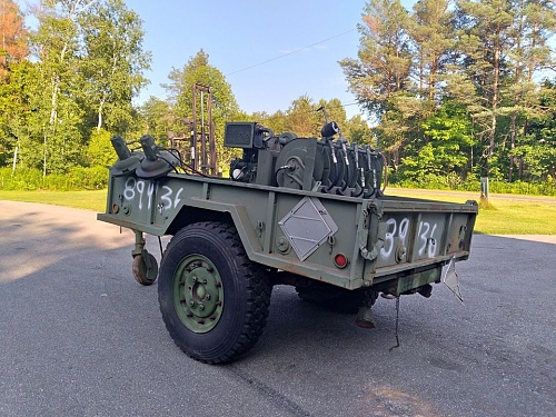

Posts: 14,930
Default Trailer, yes - but a different role
https://www.facebook.com/marketplace...b-f29e9e1531ae
...at least the content is relevant.....
That "1980 Military maintenance trailer" looks like the equivalent of the WW2 Trailer, Workshop Servicing, 20-cwt, 2-wh to me
Old 12-12-23, 23:29
Posts: 7,621
The "1980" maintenance trailer is more likely a 1984 model made by Manac for the MLVW series of trucks. You can tell it is a Manac by the big fred flinstone wheel on the hitch. The compressor and pump set are very similar to the WW2 lubrication and servicing trailers. Post war they were on the M101 3/4 ton trailers, and during the 1980s, they were upgraded to the diesel engined compressor and mounted on the M104Cdn3 1-1/2 ton trailers.

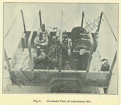

Default Lubrication Kit
Post war they were on the M101 3/4 ton trailers.
As Rob stated, the post-war lubrication kits were first mounted on the M101CDN ¾ Ton Trailer and this image is from the 1957 installation instructions.
Name:	Fig. 4 - Overhead View of Lubrication Kit - 73318.jpg
