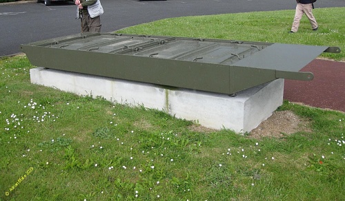

Default We've found a porpoise!
Sorry to resurrect a six year old thread, but we've found a porpoise a mile away from Gold Beach.
It's been recovered and is now under restoration.
When completed it will be displayed behind the museum's Sexton.
We need help - an earlier post talked about "a range of information" - we have none and need lots!
Plans, photos, accounts of their use, manufacturers info - all would help.
We've also found some covers in a different field, but when measured they're a different size to the porpoise. Does this imply that there are at least two varieties?

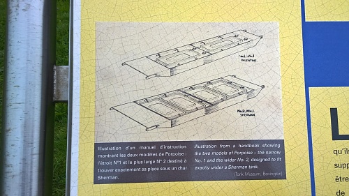

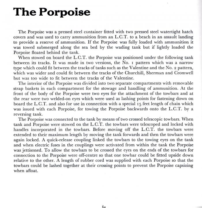

I'm not sure if this is any help, and may have appeared before.
The book "The Funnies" by G W Futter has a section on the porpoise, some photo's and a drawing.
It states there were two sizes.
The book is way out of print, my copy is 1974 (?).
George.

Here are a couple of pictures of the recovery.
Wrong order, but I think the sense is obvious!
BR
Geoff

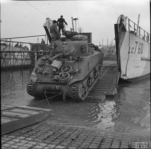

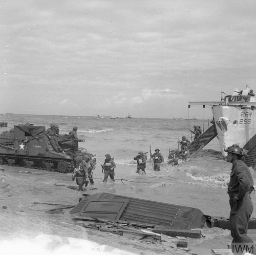

Attached you will find some scans...all shots from the IWM archive. I am trying to find the film footage showing the porpoises stacked in a Normandy field in use as an ammo depot, but haven't found it yet.
First picture shows Shermans of 13/18th Hussars backing into the LCT with the porpoises being pulled backward with a chain. After the LCT landed, a special tow bar/frame was used to take the Porpoise onto the beach as can be seen in th picture with the Centaur. The first and second picture show the bar stowed on front of the Sherman hulls. The last picture shows at least two abandoned porpoises on the beach (St Aubin-sur-Mer???)

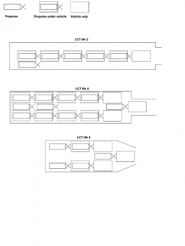

Name:	nominal porpoise loads.jpg

Could this be one of 86 Field Regt RA (Hertfordshire Yeomanry), "the only regiment to land Sexton SP Guns on D-Day (Juno Beach)"?
As per the link above: 86 Field Regt RA found that their Porpoises caused less trouble than expected. The C Troop diary records: "The Porpoises - those misbegotten children of the "War House" proved to be quite amenable to a wet landing and all were landed without any trouble. Perhaps this was as a result of the language used on them previously....".
I was sure there was pic somewhere of a Sexton and Porpoise in the same shot. Couldn't find it in any of my books, but here it is on the IWM website:
LCI(L) 295 in the background may be a clue as to where this photograph was taken. LCI(L) 295 was assigned to the RCN's 264th LCI(L) flotilla which sailed out of Weymouth with Force "G" for Gold Beach. For Op NEPTUNE, 295 was commanded by Lt (N) Peter G.R. Campbell (RCNVR).

Some photos of the restored example at Ver sur Mer (nmp, found on FB).
I like the plaques with drawings explaining how they were used.
