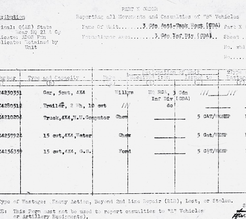

Old 19-04-24, 16:30
Posts: 14,940
Default Truck, 4x4, H. U. Computer Chev
Originally Posted by klambie View Post
The Canadian War Establishment for a Divisional Reconnaissance Regiment, CAC, dated Feb/44 indicates the following vehicles on strength:
Truck, Heavy Utility, Computor - x1
File posted by Mark Twostar in the MLU FB group:
