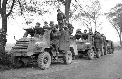

This well known (maybe even iconic) photo of a C15TA was made 80 years ago to the day. It shows infantrymen of The Royal Hamilton Light Infantry in General Motors C15TA armoured trucks at the town of Krabbendijke, the Netherlands, 27 October 1944. The Battle of the Scheldt was the first combat deployment of the C15TA.

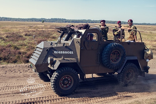

I would like to pinpoint this location for a then & now photo. It would be great to have a full line up of C15TA's complete with infantry. But for now, you will have to do with a recent photo of my C15TA.

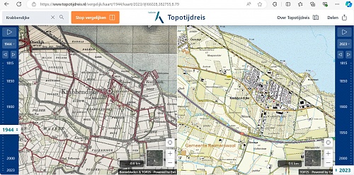

In the Netherlands we have a website where one can compare all known maps made during the past 200 years (plus aerial photos where available) with each other. So it enables someone to see a ca. 1944 map and compare it with a current map. Then, with the aid of Google street view one even can get a current view of the surroundings. See this thread for an example: http://www.mapleleafup.net/forums/sh...176#post289176
The hardest part is finding the clues on where to look on the map. In the case of the Fort Garry Horse photos the road signs helped tremendously. For the case above I have asked the help of a local historian. Let’s see what he can come up with and then try to make the then & now photo.

I was going to suggest trying to find someone with good knowledge of the area, because that photo has so few clues in it that it could be virtually anywhere in the world at first glance. It looks to me like a main road, because it appears to be fairly wide, but that’s about all I can come up with.

Hanno, I have a hunch it's the "Oude Rijksweg" between the "Schapendijk" and "Bolwerk", like Jakko says, the old main road, west of Krabbendijke.
You're quite right. Was the photo taken in or near Krabbendijke, or even Oud-Krabbendijke? We need local knowledge and research into unit histories and the like.
The troops seems to have largely followed the Rijksweg (main state road) which ran through Krabbendijke in the 1940 and is now mostly the N289 road.

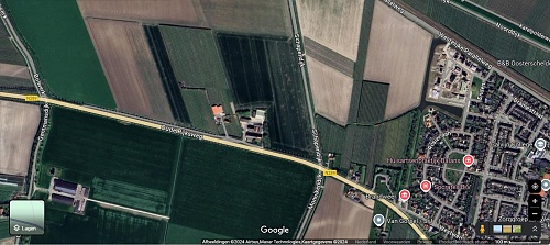

Thanks Alex, only saw your reply after I replied to Jakko. I looked it up on the map and you could be right. In the background of the original photo I think I see fruit trees? Along the Oude Rijksweg there are a couple of orchards. It seems most of the original trees lining the road have long gone, although new ones have been planted.
Then there is the building in the background on the right... could this be the spot?

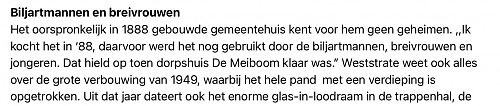

The building was the town hall until 1970, when Krabbendijke ceased to be a separate municipality, but I can’t find when the post-war building was constructed. It looks 1950s to me, though. There is this article from 2018 about when thethen-owner sold it, but that’s behind a paywall. But using an iPad from someone who does have a PZC subscription, I discovered this:
Men playing billiards and women knitting
The town hall, originally built in 1888, has no secrets for [the current owner, Mr. Weststrate]. ”I bought it in ’88, before then it was still being used by men playing billiards, women knitting and teenagers. That ended when community hall De Meiboom was completed.” Weststrate also knows all there is to know about the major reconstruction of 1949, in which the whole building was raised by a storey.
So it is the same building, even though you would’t think it is.
