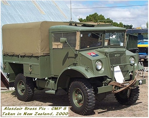

Old 11-05-06, 15:01
Posts: 14,934
Another C8AX survivor. Don't know the s/n.
Source: http://jeepdraw.com/Trailer_Canadian.html
Last edited by Hanno Spoelstra; 20-11-17 at 17:54. Reason: deleted link and attached picture
Old 11-05-06, 15:12
That's -606, shown above. Owned and restored by Arthur Poll.
Old 11-05-06, 15:17
Posts: 14,934
Ah yes, I see it now. Sorry 'bout that, but those CMP's all look the same, don't they
