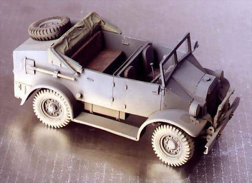

I could only find some pictures on the internet of a scale model kit of a 15-cwt CMP Kübel. If anything, they help to show how a Kübelwagen body (built along a largely standardised design) was fitted to captured chassis like the F15.
Picture source: http://www.tracks-n-troops.com/Wespe.htm

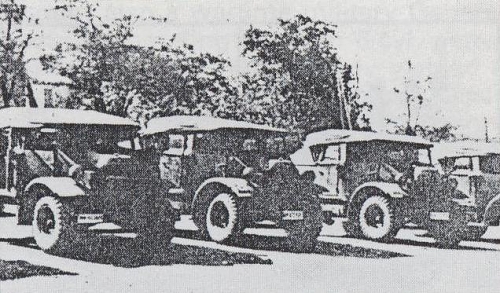

I just looked up the article "The Wehrmacht's Umbau-Wagen" (Wheels & Tracks issue No. 30, p.20-27) in which Bart Vanderveen mentions:
The first category Umbau-Wagen, the sophisticated Kfz. 15 (and similar roles) or Kübel-type car bodies on foreign military chassis which had been abandoned mainly in France and the Western Desert, all in the period of 1939-42.
Canadian chassis used for similar conversions probably originated predominantly from Greece; some of them (e.g. WH-449955, on F15 chassis) saw service in Russia. Like the German originals, these models all had the pioneer tools on the sides of the rear locker. Later, when additional jerricans were carried on the sides, shovel and pickaxe were moved to the rear.

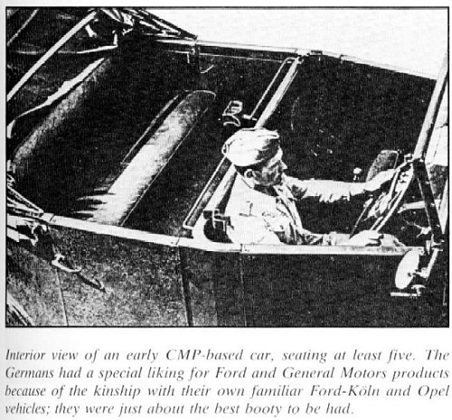

Default 'Kfz. 15 (Behelf) (Ford V8 1,5 to engl.)'
I just looked up the article "The Wehrmacht's Umbau-Wagen" (Wheels & Tracks issue No. 30, p.20-27) in which Bart Vanderveen mentions: "Canadian chassis used for similar conversions probably originated predominantly from Greece; some of them (e.g. WH-449955, on F15 chassis) saw service in Russia."
The "Reader's Forum" in W&T issue 32 featured the following interesting tidbit:
The article about the Wehrmacht's Umbau-Wagen (W&T 30) brought an interesting reaction from Herr Reinhard Frank in Bavaria, who sent me a picture of a line-up of the Kfz. 15 cars on CMP F15 chassis, plus some original drawings of the conversion, which was apparently executed in Athens in late 1941 by the Pi.Btl.666 (666 Engineers Battalion) for Pi.Btl.659 who took them to Russia. 15 were converted and they were known as 'Kfz. 15 (Behelf) (Ford V8 1,5 to engl.)' which translates roughly as makeshift Kfz. 15 on chassis of British 1.5-ton (sic) Ford V8 chassis. Not surprisingly, these troops also used the original F15, in GS truck form; it would appear that they captured quite a few of them during the actions in Greece. Herr Frank even sent us a copy of a letter dated October 3, 1941, in which one Generalmajor Meise expresses his appreciation of the 'Kfz. V8' into 'behelfsmässige Kfz. 15'. He also enclosed a number of copies of typical soldiers' snapshots showing German and foreign-origin vehicles, which we very much appreciate.
The above seems to indicate drawings were made up so local Engineers workshops could carry out the conversions, rather than having the trucks transported to factories or coach builders for conversion.
The picture printed in W&T goes attached:

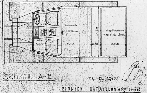

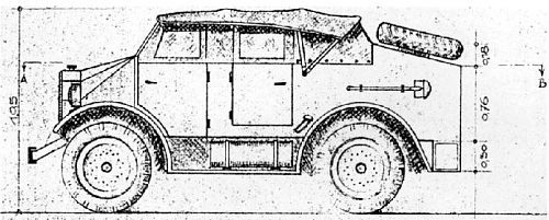

I recently found out the original drawings of the conversion are featured in Reinhard Frank's book Ford im Kriege. LKW -Maultier- PKW (Waffen Arsenal, n°123, Vienne, Friedberg, 1990).
This body must have been a local conversion, only loosely modelled on the Kfz.15, contrary the body on the Bedford and Morris-Commercial Umbau-Wagen which are almost exact copies of typical German Kübel bodies. Instead of the typical steel triangular doors as found on the Stoewer, the 'Kfz. 15 (Behelf) (Ford V8 1,5 to engl.)' has square doors and bench seats, both very non-German. Interestingly, the rear body with its slanted back reminds us of the Quad Gun Tractor body.

The top view shows that the F15's cab was retained (albeit without roof, which could be easily unbolted), and the body from behind the front doors was fabricated. Again this is different from the typical German Kübel body which was a full body from the cowl rearward.
I reckon the body was a wooden frame with steel sheeting construction.
The Gepäckraum (cargo compartment) was used to carry 1 kl. Floss-Sack (1 small rubber dinghy), befitting its use by a Pionier-Battaillon (pioneer battalion).

Old 25-07-06, 16:49
Posts: 14,930
Another picture, found on the Axis History Forum. Writing on the back suggests this vehicle was left behind in Russia in 1943.
Old 02-11-06, 17:45
Posts: 14,930
Default Re: Re: 'Kfz. 15 (Behelf) (Ford V8 1,5 to engl.)'
8 May 1941: CMP Cab 11, captured by the Germans, on its way to Athens - where it was converted into a 'Kfz. 15 (Behelf) (Ford V8 1,5 to engl.)' later that year?!?
Linked from As good as new...
