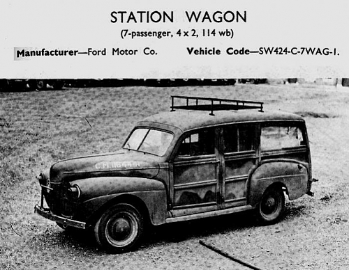

  2. CM1164447 Ford Station Wagon
  3. CM1165332 Ford Station Wagon

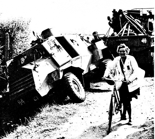

  27. CM4245668 wrecker

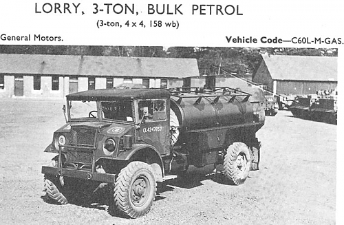

  28. CL4247550 C60L Cab 13
  29. CL4247857 C60L Gas Cab 13

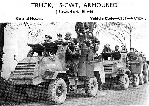

  41. CZ4287905 C15TA Cab 13
  42. CZ4287946 C15TA Cab 13
  43. CZ4287985 C15TA Cab 13
  44. CZ4288020 C15TA Cab 13

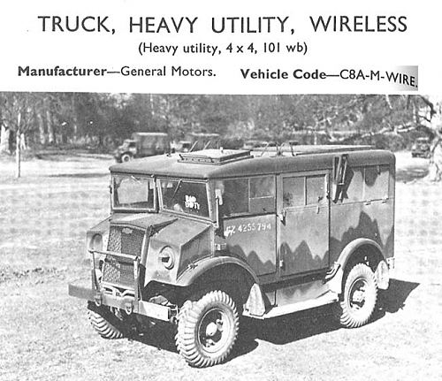

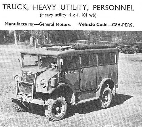

Here's five from Canada's Fighting Vehicles. I was kind of surprised that the White fit the category.
Note the two penthouses on the HUP.
ID:	26683 Click image for larger version
ID:	26684 Click image for larger version

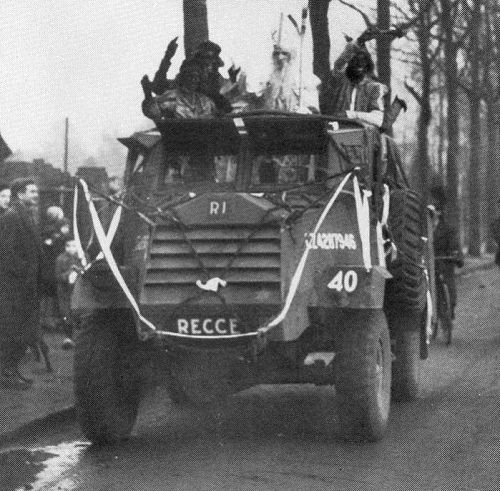

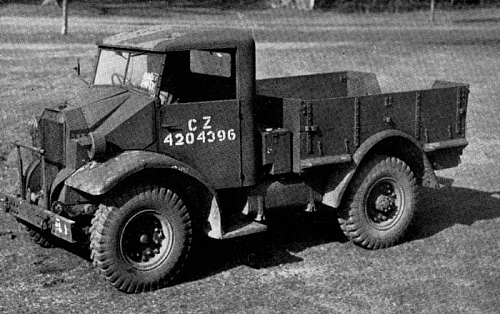

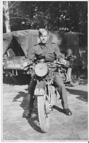

I dug up a few more. It's quite surprising how far out the numbers on a lot of the restored vehicles really are. Maybe this thread will help solve that problem. I'm going to delete all the references with no pix for that reason.
The CZ numbers seem to go from about 4204000 to 4290000. That's about ninety thousand 8 cwt and 15 cwt vehicles in Canadian service overseas. According to Canada's Fighting Vehicles there were 133442 vehicles of the types I've found produced. When you take into account the ones that stayed home and the ones that went to other countries that makes me think there must have been large gaps in the numbering system or more types included.
ID:	26739 Click image for larger version

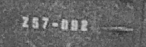

Default Here is a Pattern 12 in British Columbia during the war
Here is one picture from a batch I bought on E-bay a few years ago all of the pictures are posted on http://www.canadianmilitarypattern.c...20Columbia.htm . The picture below is the only one where the number is readable. Z57-092
Just added blow-up of door number
Name:	CMP service photos 10-20-06 13 with text for web.jpg

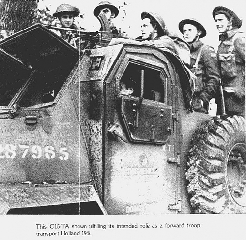

Phil, the number that you posted is for a vehicle that never went overseas and as such is a different numbering system. I'm going to expand this to include all of the softskins so I'll post these.
ID:	26869 Click image for larger version

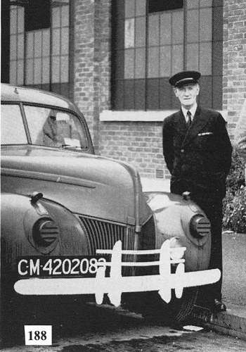

I'm scanning the C series pix from Canada's Fighting Vehicles. Here's the first five.
ID:	26876 Click image for larger version

F8 CZ4204797 was most likely pictured in the UK. As noted earlier:
As per the manual, by 1944 they were "used only in limited numbers in the UK as general purpose load carrier for supplies and stores over good roads by CRU (Canadian Reinforcement Unit) or other base units."
It was not used in Canada, as at home they used a different census numbering system, of which Phil waterman posted an example.
As Mike says, they were used in action in the North African and Middle East theatres of operation. Attached goes a picture of an F8 captured by the German Afrika Korps and put to good use.

Here's five more.
ID:	26986 Click image for larger version
ID:	26987 Click image for larger version
ID:	26988 Click image for larger version
ID:	26989 Click image for larger version
