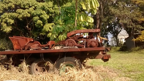

These trees are 20 years old and these trees contained Chev blitzs, or the remains of them

Using the chainsaw I soon had these trees pruned
I was going well until I snagged a concrete block with the chain, instantly causing it to refuse to cut any further
so I was stumped.

The good crane truck man swung the chassis around, back and forth and eventually broke the remaining woodwork.
The little crane could only lift one end on then the other of the main chassis
All in all a bit of a battle to get them loaded.

A long time ago, I had bought two wrecks of Ford trucks and a wreck of a Chevrolet
A C15 that was once a wireless signals van and then another Chev which I thought was a C60, in the panic to load while the crane was there

After I got them home and started to look at them properly, the C60 had been in-fact a C15 Sig van chassis that was chopped and extended.
I decided to take the front axle from this and fit it to the good C15 Sig chassis that had a strange front axle
I did not realise at that time the cab on this extended chassis was also from a chopped sig van
The cab floor and the nose section is in reasonable condition
The top of the cab had been beaten into a semi-rounded shape
The dash is ruined but a few switch tags and the ignition switch will be usable
I had that spare Chevy engine
I kept a lookout for transmissions, and maybe a better Cab
Then I had asked around to locate a reasonable C60 chassis
This is the reason why I found the chevys in the trees as posted above
Chassis count - four- maybe two are good to make trucks, a sig chassis and a C60
And that cut and shut long chassis, mmm, chop it back short, add a turntable and voila - dog trailer, 16 inch on front 20 inch on back
Did I see a big box off an ambulance in a paddock somewhere? thats got me thinking
And I was learning fast about blitz trucks
1st lesson - This is not the way to build a cheep truck
