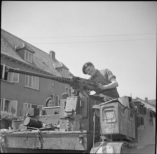

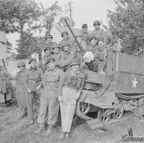

Old 23-04-20, 12:11
Posts: 14,940
Have merged pics of .30 or .50 cal armed carriers I found on this forum to this thread.
Here's one more, don't know when this was taken or which unit is depicted. One can imagine an MG had to be moved to the top of the armour with all that stowage on the front of the carrier...
Originally Posted by lssah2025 View Post
I am looking for some bits and bobs..
2. Mount that was used/modified (to use) the M2HMG or 1919 up front. (see pics)
Some more pics here: http://www.mapleleafup.net/forums/sh...ad.php?t=12170
Originally Posted by Stewart Loy View Post
I have attached a picture of the box bracket in use on a M2 by ANZAC troops in a desert far away, long ago.
Originally Posted by Mark W. Tonner View Post
Source: Imperial War Museum
Reference Number: B 5185
Photographer: Mapham J (Sgt)
No 5 Army Film & Photographic Unit
Title: THE BRITISH ARMY IN THE NORMANDY CAMPAIGN 1944
Collection No.: 4700-29
Description: Men of the Staffordshire Yeomanry crowd in and around a universal carrier for a portrait, 7 June 1944. The vehicle is equipped with a .50-inch Browning machine gun, 7 June 1944.
Period:Second World War
Link to the source of that IWM picture, check and zoom in for details: https://www.iwm.org.uk/collections/i...ject/205201960
Name:	IWM B5185.jpg
ID:	113489 Click image for larger version
Name:	IWM B5185 (2).jpg

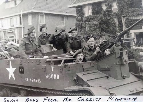

Old 09-02-21, 10:24
Posts: 14,940
Default Some Boys from the Carrier Platoon
From a series of pictures of Private Max Doughty, while serving with The SD&G Highlanders.
Source: https://www.facebook.com/groups/1117...0092629163631/

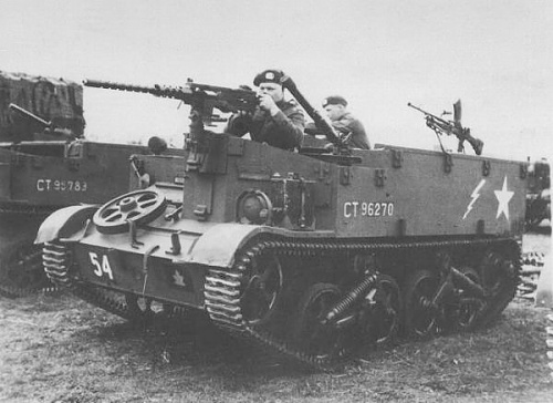

Old 25-02-21, 23:57
Andrew Morrison Andrew Morrison is offline
Location: North Yorkshire
Posts: 31
Have a picture of a Canadian carrier of the 1st Battalion Queens Own Rifles at Camp Wainwright preparing to deploy for UN service in Egypt dated 1956. Will put up the picture when near a scanner
The crew of 4 are all looking very serious in a Ford Canada carrier with what looks to me (who is no expert) to be a 30 cal - belt fed air cooled machine gun with a pistol grip - mounted on the air scoop
Old 26-02-21, 06:31
Join Date: Jun 2011
Posts: 1,171
Originally Posted by Andrew Morrison View Post
Have a picture. . .
Browning 1919A4 .30 cal.
