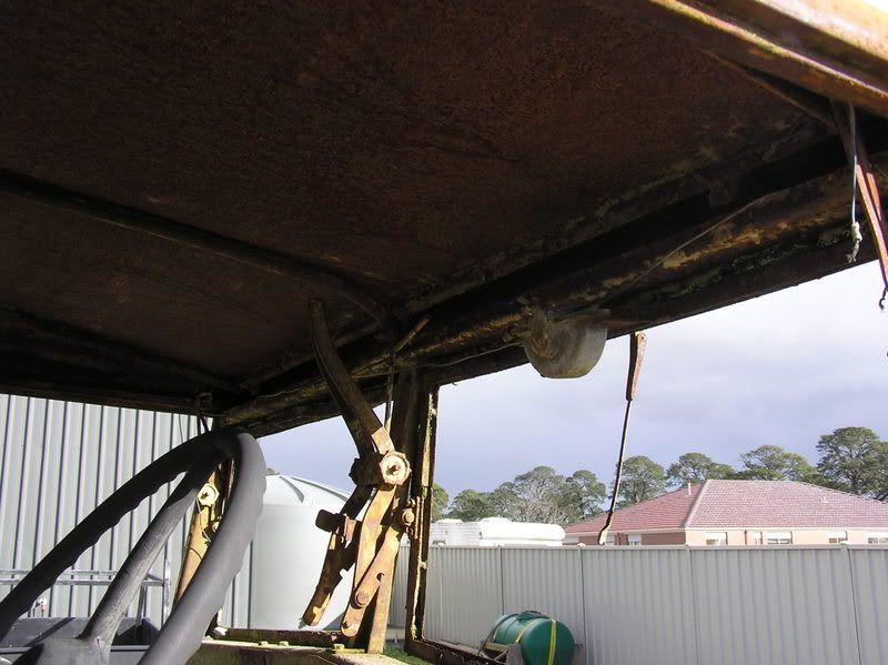

Interesting photo of the windshield opening and closing mechanism. Is this a post-war mod or just another Aussie product improvement?
RHC
It's just one of our war time improvements, started sometime in 1943 and we find it on ford and chev

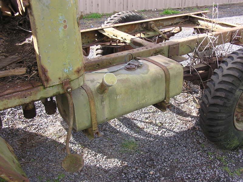

Keith i also found on the fuel tank of my F15A some information of a previous owner it reads ` &Sons Durham Lead Ararat ` i have some friends that live up that way so i am going to try and track down the previous owner and see if they have any of the missing parts .
Whats involved in modifying the spare wheel carrier ? should i save this one and use it as a template to make a 16inch wheel version how rare are they ?
