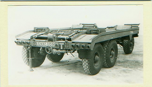

ITs about time this subject was included, so manytypes to cover i feel there will no shortage of imput
1. crane 7.5 ton light recovery trailer loading Carrier

What's the handcrank on that 6wheel 7 ton trailer for? Is that for the built in winch? I've been eyeing one of these over in the Netherlands for some time now. Seems like it would be a nice piece of kit at WWII events.

Nice trailer photo, thanks! H 4427874 is from the Scammell batch H 4427762 - 44427892 to contract T.8056 'Tractor 6 x 4 Break Down'.

X 333817 to 4333816 T.9064 TRAILER 6-TON 6-WHEEL RECOVERY

Hi Ryan,
the correct truck, as the Scammel in the picture would be too slow over here, and just about anywhere in the world now, 24mph flat out.
Dave

Originally posted by Dave Page
Hi Ryan,
Dave
I kind of think that a Slightly post war 5 Ton with a bit of modifications to make it look like a WWII era Mack NO or Diamond T would work well. I think the trailer has air operated brakes so that's a key piece that more or less excludes a CMP C60X as much as I like the look of them unless it's a 2.5 ton or 5 Ton dressed up to look like a C60x, then the brakes would work just fine and you'd get some decent speeds out of it. Neat thing about a 2.5 ton is that the singles on it raise the tire diameter and raises the maximum speeds to around 55-60 MPH. A fair bit faster than that Scammel.
Did the Scammels have an Air Glad Hand on the back for the trailer brakes?

Hi Ryan,
if by "Glad Hand" you mean a bayonet air connector, then yes. The SV2S has air-on brakes to the rear wheels, the front are steering only.
One problem with increased speed in regards to a 7-1/2 ton trailer would be the tyres, 9:00 x 13's, I think. Would they, and the bearings hold up to the strain? Might be just better off with a modern trailer.
Ryan and Dave,
These trailers did not have air brakes, the early ones had cable operated brakes. The towing vehicle had to be equipped for towing guns with the gun cylinder attachment though.
They were mostly used behind a Breakdown Gantry, either Leyland Retriever, Dodge WK60 or later on, the Austin K6 and with these vehicles you had vacuum facility, so later trailers were single line vacuum servo operated. Earlier trailers were uprated later on. Also there were no brakes on the front axle. Tyres were 10.50-13 which is harder to get than 9.00-13. I recently sold a new one, for a chap restoring a Scammell Mechanical Horse. Not a trailer you would wish to take much more than 35 mph I think.

Hi Richard,
ahh, the old Bowden cable. In a nut shell, not a suitable trailer for today's roads.
Dave

Dave,
Would be alright over here, so much traffic you could'nt go too fast
No suspension as such either, rocking axle on front and pivoting on the rear, much like a Scammell.

The data page I have out of a book shows the 6w7t as having Air over Hydraulic. Much like most Military Trucks today. At least the ones that are in the surplus market and in partial use still.
Bearings would get replaced, hopefully with something OTS that's easily available. I could see re-machining a part or two to get it all to fit. I suspect that after sitting for 20 years at least, that the bearings would need replacement as the upper part of the races would have been spot corroded at one point or another and you'd eventually have a bearing failure in your future.
I'd have to see how it'd really perform to see how it'd work on the roads were I to get one. I'd greatly prefer to have a tow vehicle that could take my WWII vehicle to our re-enacting events and I wouldn't have to hide my clearly post war truck and trailer after unloading. I'd prefer to have a period looking truck, a period trailer and my period armored car all in the same area. Makes for less walking back and forth for tools and kit that one needs.
Ryan,
I see you are refering to the 7 ton light recovery trailer, that is shown in the Canadian Data Book, it would appear that they were built in Canada to AEDB specs and differ in a few ways, presumably to be compatible with vehicles in Canadian service at that time.
The ones often found in UK are British built by Cranes trailers and are 7.5 tons payload, brake systems are as I refered previously. If they were air operated they would not have been able to operate with 3 ton 6x4 B/down Gantry trucks, which have vacuum facilities.
Hi Ryan,
Dave
I think the tyre size is actually 10.50-16, isn't it? If your load was only going to be a Carrier weighing no more than 4 tons, then a set of 6x 9.00-16s would be sufficient for the load, and more widely available and cheaper.
Hi Tony,
No, they are 13" rims, as I mentioned earlier, same size as used on the Scammell Mech. Horse or Scarab. If larger diaeter wheels were used, a fouling problem could occur as the rear axles have to pivot.
Yes they were and they do differ, wheel size and brake setup being among them. Donīt ask me for all the differences, though!
Ryan, Iīd rather see you pull up at a show in a 1960/70īs rig which is it original configuration, than having been "vismodded" into something which it is not.
