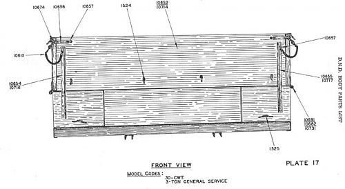

I am looking for photos or drawings of a 10 foot all steel no 3A1 MGO body as we are looking to make one up for our C30 cab 11 any help would be appreciated.
Does anyone out there have one of these body types
Max

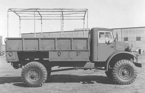

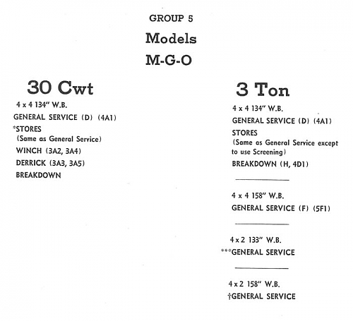

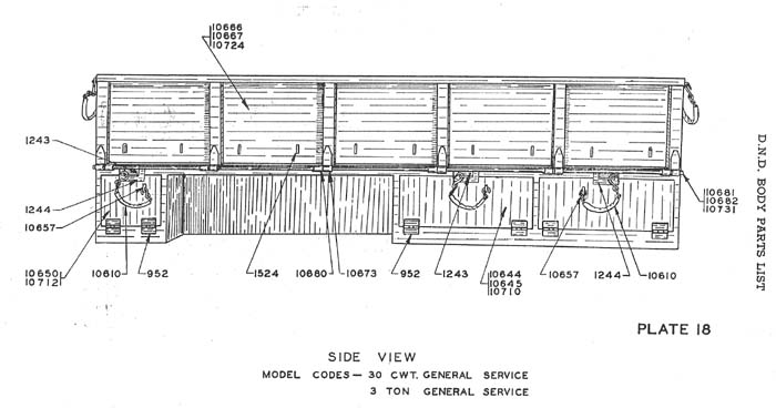

Max, I looked through my factory photos CD and 1941 illustrated body parts list and came up with the following. It seems there's a typo in the model # for the 30 cwt general service body. It should read (3A1).
The 3A1 on an 11 cab.

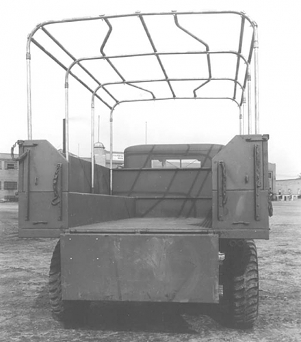

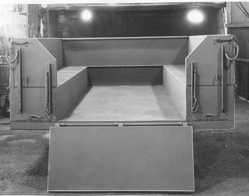

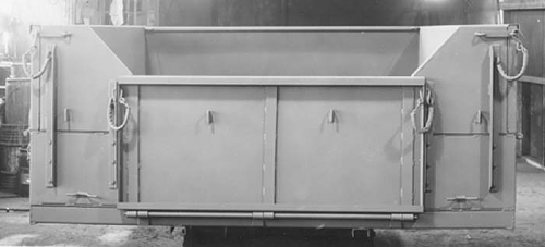

Old 30-11-07, 02:12
The parts list says the first type had hinged sides and the second type had fixed sides so I guess this is the first type.

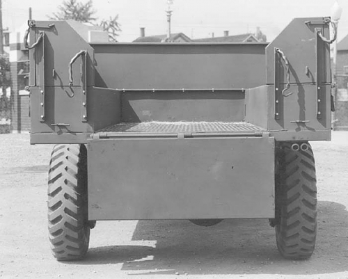

The front end.
End gate open.

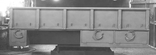

End gate closed.

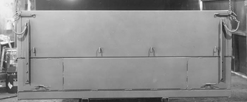

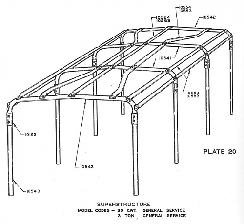

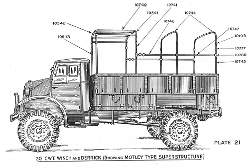

Here's the GS type superstructure. You didn't say which type you were interested in.
Front panel from the parts list
Name:	parts front.jpg
parts list side view.

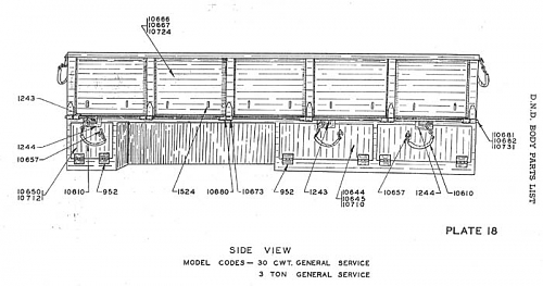

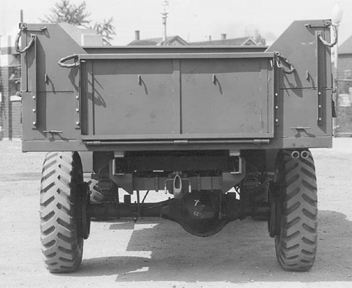

parts list rear. Max, on one of your posts on your other cab 11 thread you asked about the chicken handle. All of my 11 cabs have them.

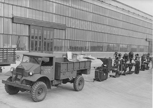

I found some more on the factory photos CD.
end gate open.

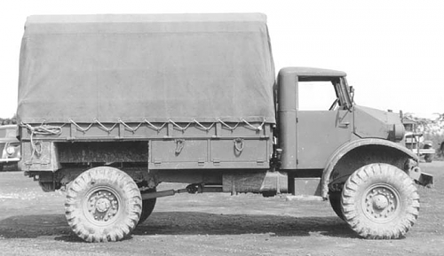

Old 30-11-07, 02:52

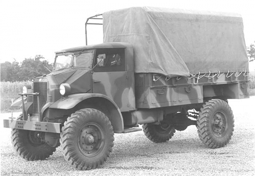

This one has one of those discussed three tone camo jobs.

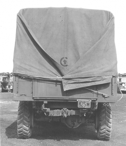

I'm not sure what they're trying to do in these next two pix.

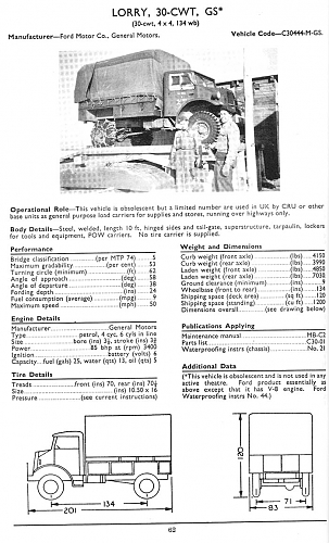

Old 30-11-07, 03:06
Here's the page from Greggs Canada's Fighting Vehicles 1943-45.
Name:	canadas fighting vehicles.jpg

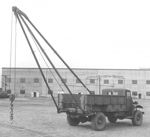

If you have a winch you could always come up with the derrick version. The box is the same as on the GS versions. The super structure pix I posted is for the Canadian GS body.
Name:	8441 derrick lorry 630-181241.jpg
This is the general service body. The one type of superstructure is for the GS variants and the other type is for the derrick types.

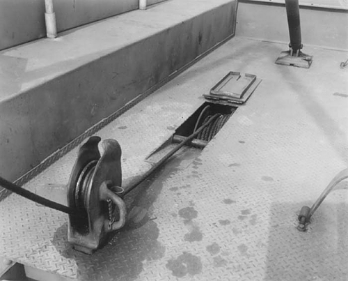

The inside of the box on a derrick truck showing winch setup.
Name:	8441 derrick lorry 631-181241.jpg
A side view without the tarps. These pix should help quite a bit there Max. I'll scan the parts lists and post them in the next day or two.

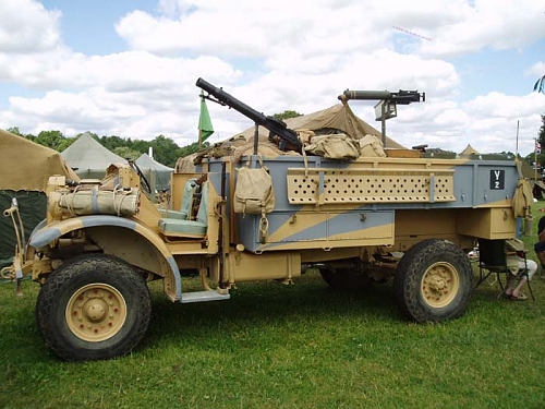

Old 30-11-07, 12:05

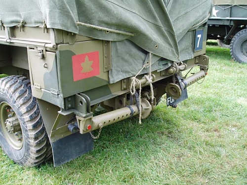

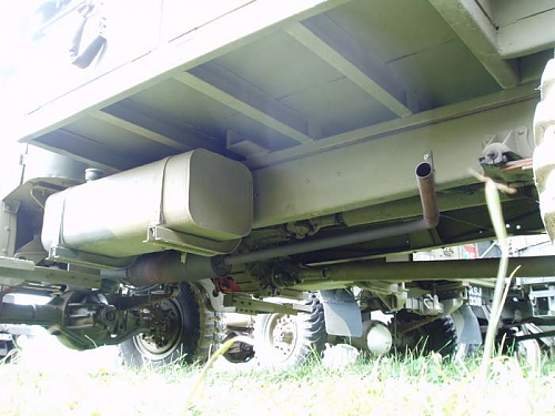

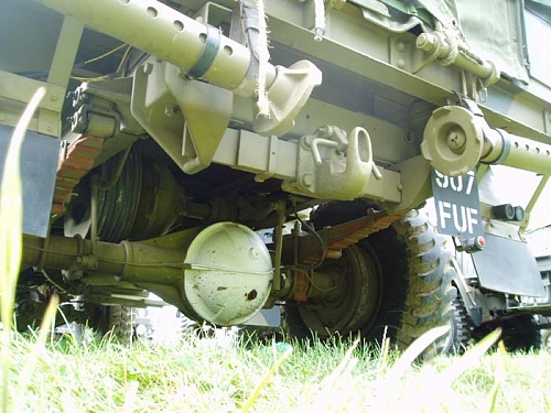

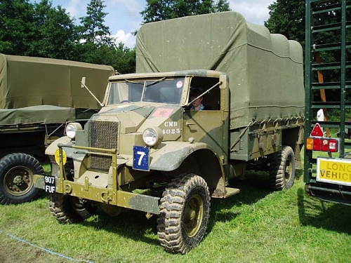

Max,
I hope these help....
Taken at Beltring 2007
Alex van de Wetering

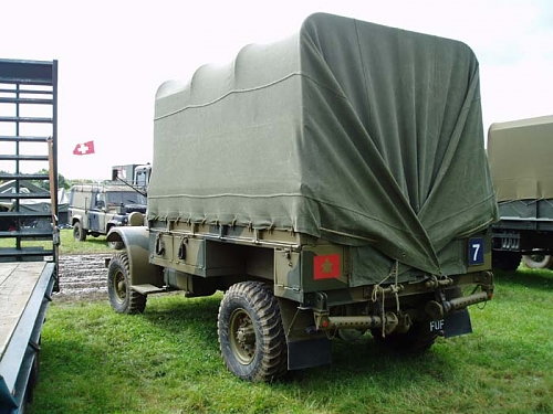

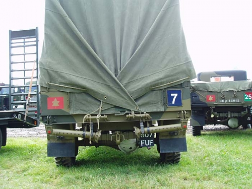

Old 30-11-07, 12:06
more pics:
ID:	18184 Click image for larger version
ID:	18185 Click image for larger version
ID:	18186 Click image for larger version
ID:	18187 Click image for larger version

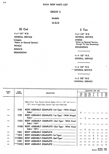

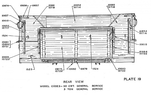

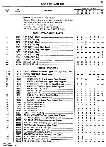

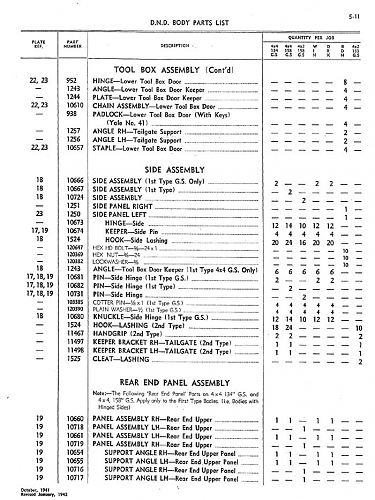

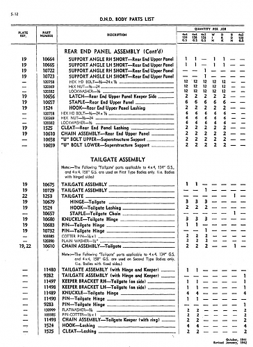

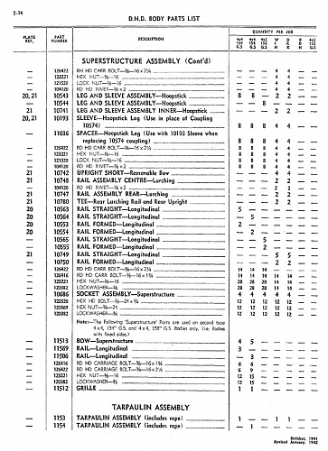

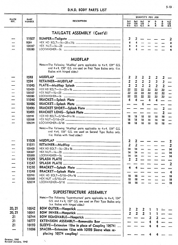

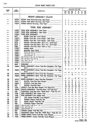

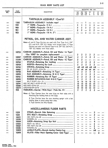

The next 8 posts are the parts list pages.
That parts list manual from Alex Blair is a valuable resource for anyone with 11 or 12 cabs.
The breakdown body on these pages is different from the rest. I don't know why they put it in with the rest of them.
ID:	18192 Click image for larger version
ID:	18193 Click image for larger version
ID:	18194 Click image for larger version
ID:	18199 Click image for larger version
Old 30-11-07, 16:50
In the manual they also list a wooden version but no pics.
Almost done.
Last one. Now about all you'll need are some measurements.
ID:	18201 Click image for larger version
ID:	18202 Click image for larger version

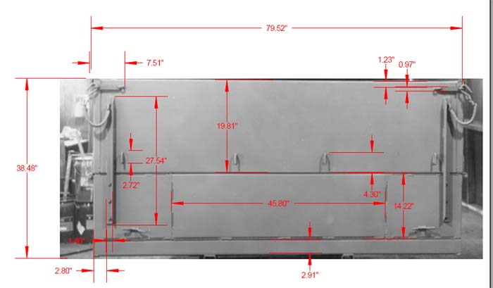

Max, the floor and other panels will likely be the same gauge on most types of body. Note that the floor sheets fold up about an inch along the sides. This was pretty common on the various bodies too. Around here it's easy to find a shop with a 20 foot wide metal shear and break. On a lot of the bodies the floor panel is two pieces joined down the centre but in the pix it looks like this one is one piece.
I came up with these dimensions with my AutoSketch program. The only measurement I had was the 201 inch length so I cropped the pic at the front bumper and rear of box then did measurements on my work page until I had 201". Next I inserted the picture inside those measurement lines and presto! Now with the dimension tool I could just click on any two points and it puts in the measurements. Kind of neat! I'll do the front and rear views too. In the real world the measurements would be in 1/4 or 1/2 inch multiples instead of decimals like I ended up with.
Old 02-12-07, 21:12
Excellent job mate but I would be a little wary of the length measurements as the photo is not true square on so this will vary a bit. Vertical height measurements should be pretty right though.
Old 03-12-07, 01:36
Cliff, it's close enough to being straight on that the differences will be minimal. Here's one more.
