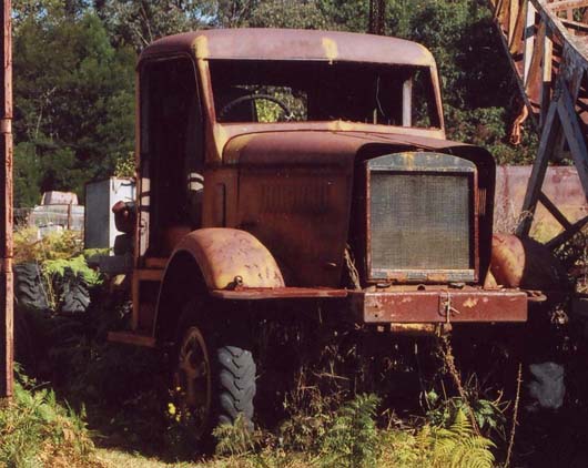

Hi Everyone,
Would anybody be able to help? I am chasing some information (on behalf of a mate) on FWD trucks used during WW2. I have attached two pictures - the first is the picture from Bart Vanderveens Fighting Vehicles. The second is the actual vehicle. It is missing the original grille and doors. The front guards are different to the one pictured in Barts book. It still has some of the Austrailian Army numbers on the bonnet and still has its small marker lights at the front which are the same as those found on Blitz's.
Thanks&Regards,
Brett Nicholls.

Second picture - actual vehicle

here is 2 AWM photos of FWD trucks used to tow searchlights.
Old 21-01-08, 05:34
Photo 2
Both were taken in Moorebank NSW 1946. You will note that these have the same mudguards as your mates one.

Are you sure it is one of the 1200 tractors and not one of the searchlight tow units?

Hi Cliff,
Thanks for the pictures. Im now not so sure it was a Truck-Tractor. Your right about those front mud guards they look exactly the same. I have attached a rear picture of the said mates truck which shows what looks to be the original turntable plate though I admit this could have been a post war addition. I wonder if they were the same chassis lengths? That maybe another way to differentiate between the two. So far your AWM picture is the best match. Thanks.
Brett Nicholls.
Old 21-01-08, 07:44
From the rear view it seems to me your truck is not a short wheelbase tractor unit. If you view the photo taken from Barts book the rear wheels are just behind the fuel tank where as the photo of yours shows that the rear wheels would be further back.
My guess is your truck is one of the searchlight tenders as shown in the AWM photos or a similar bodied GS truck and not a tractor unit.
Can you get the full ARN off the bonnet as this may lead you to it's original use?

Hi Everyone,
Thanks to all for the loads of great information. I have since found out that the truck has the original trailer attachment - equivalent of a turntable, though this is the old type that is not intended to uncouple easily and was typical of some types of WW2 trailers. I hope to have pictures of this and its original Australian Army number.
The truck is missing it's front grille and doors - so would anyone know of spares to suit? even if located outside Australia. Thanks again.
