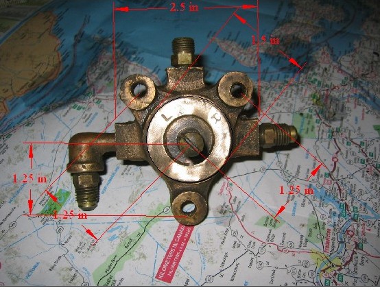

Hi all,
I am chasing a 2 position fuel valve for my C15A, is there a substitute around or does someone have a spare?
John Stokes

John-
Don't remember the source off the top of my head but the fuel valve you are looking for is virtually identical to some that are commercially available. Try looking on line in heavy truck sources and marine parts. I found one a few years ago that was a dead match for the Chev CMP except for the handle and the length of the shaft. Both of these were easy to modify.
Do you need a picture of the original valve or dimensions?

John,
As a last resort, try one out of an OZ Ex-Army Land Rover. These had duel fuel tanks and the tap is between them. It is easy to fit and doesn't look out of place.
Rick

Thanks Phill a picture and dimensions would be helpful.

Default Selector Valve Pictures
Here are pictures of the valve from my Pattern 12 C60L but is the same as on both HUP and Pat 13 C60S

Dirk has them for sale (http://www.lwdparts.com/):
Switch
Valve assy.
Fuel line 2 way
Part no. GM-5807108
Price: € 40,00
