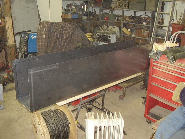

As indicated in the to Glue or not to Glue thread I have started on that most elusive creature for CMP enthusiasts. The legendary Spare Tire Carrier and Tool Box.
First off I wish to thank George Mackenzie for his comprehensive plans, they truely are a must if you are going to persue this endeavour.
I have deviated slightly from his process but I am sure the end result will be the same.
I sourced out the initial big stuff to a sheetmetal shop to bend and shape. From there on it will be head-skratchin', thumb bangen and picture taking.
Here is the start....
Mike in Windsor.....more snow and s..t tomorrow

Well, I got some angles cut and some small "chunks" ready. I am now concentrating on all the little stuff and musing over the "clam shells". I have several ideas but haven't made up my mind yet. They will no doubt be the last pieces made.
Oh ya, appologies to George McKenzie....I note your an Mc not a Mac
Pic of progress....
cheers
Mike Timoshyk in Windsor Ontario

As mentioned, I have been musing over the clamshells. I don't know if you are aware, I am one of those who purchased 10.50 X 16 tires for my F15A. Now I know they are not the correct size for my 15 Cwt but damn they look good on "her". That being said I am planning to "modify" the clamshells to accomodate the width of the tires as I bought a set of 5. I believe they will be wider than the correct ones for the 9.00 series tires. I am considering making a concrete mold, turning up the ol' CW music, find my ear defenders and excersize my cork-pulling arm.
Mike in Windsor Ontario

Considering the complexities of trying to form clamshells, I would think that having some sandcast in malleble iron would be the way to go.
Not 100% authentic but the cost of making dies to stamp repos and the need for a 2000t press would be somewhat "prohibitive".
I'm sure one could scratch build them from a few pieces welded together but hey, lots of elbow grease for sure....
Just a thought.

Currently working with 1/16 (16 guage) plate and not too maleable. Since I am planning to form ones to fit the 10.50s, I am already parting from original specs. Easily changing clamshells at a later date for someone who will be the next custodian of the truck will bring it back to proper spec. Any way....there are many possibilities for which material to use. With a coat of paint one would be non-the-wiser. Brass...copper....aluminum...etc.
I will be experimenting to find the right kind of material for the job. Considerations....strength, maleability, rigidity...you get the point.

Default CMP Toolbox Day 3
A little progress....had some snow to clear after the plow came by.
Cut the curve on the 2 sides to accommodate the spare tire and did some layout work for the partition and the top. I have no plasma cutter but have managed to scarf the material with a grinder and then used tin snips and bending back and forth...and finish off with the grinder. All in all not too bad. The top is 1/8 plate....I will probably use the good ol' gas axe tomorrow.

I finshed making the final cuts to the bottom of the box and proceded to use the glue to put the bottom in the box. After it is set and dry I will do a few welds here and there. I placed the top on to get the correct distance between the two sides. It is not on there permanently yet. Tomorrow I will take the top off and insert the partition and the one inner brace. These will also be glued in with just a couple of welds afterwards. Then I will fabricate the lids and doors and the weird angle piece for the ends.
for now...
Mike in Windsor On

Default Mix of weld and glue
Hi Mike
Suggestion, depending on your type of welding pinch spot, mig weld etc you may want to decide on where you are going to weld mark the spots and not use any glue in those locations. The reason I've tried mixing welds and door panel glue and it did not work well. When using pinch spot weld the glue acted as insulator and thus not weld between the layers and if you crank up the heat you get a melt dent. When using mig welder similar problem enough heat to weld burned the glue. The solution is leave marked glue-less areas about the size of a dime.
PS I like the glue system of attaching door panels on modern car doors because you can get a more rust resistant sealed seam.
