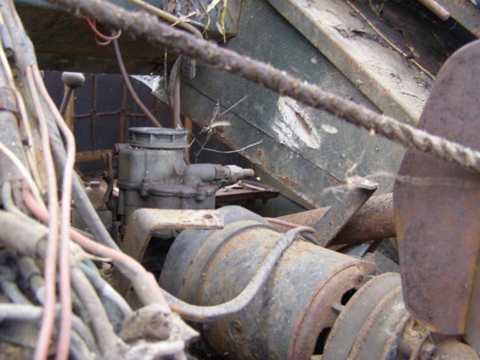

Big question fellahs,
These are picture of Howards truck & the cab 12 air cleaner which has the offset unlike the 13 Cab Fords that don't.
I have a NOS air filter which does not have any bolts brazed to it. Howards from the picture clearly has some bolts brazed onto the offset.
Does that mean this is a modification? (sure looks like one) or is there a bracket that perhaps goes around the air filter and connects to the two rods that bolt onto the engine?

Air cleaner is correct but the brackets are a add on
Probably not a bad idea though as to not damage the carby throat or top

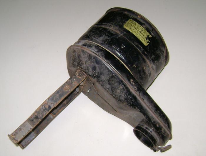

Can any one else offer any input?
Hi Tony, two pics of a N.O.S. air cleaner + bracket.
Dirk

Thanks Dirk - invaluable!
So the plot thickens!!!
Mick & Dirk have the same sort of set up. It would appear this may be the factory setup perhaps???
