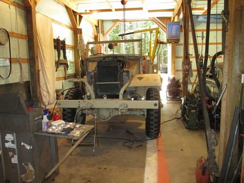

Hi All

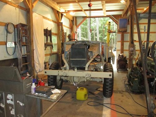

My `41 Pattern 12 C60L has been a long term project it has been on the road for a number of years. But the nose frame on the truck has always been bent despite using a porta-power the bend meant that things didn't fit correctly, and the right fender had been badly crushed. A number of years ago, Bob brought a straight cab frame and front fender down to the Weare Rally.
Well I finally decided it was time to swap out the cab frame and replace the front fender, the side of the originally cab frame was so bent that a good fender could not be mounted.
The other part of this project is to try and solve a chronic engine overheating problem. Which I think is being caused by crud in the engine water jacket, despite repeated flushing. This engine was a running replacement that can work all day at low gear with no problem. But try to drive it over the road at air temperatures above 70F / 22C and it would start boiling. I've had a freshly rebuilt 235 sitting on the engine stand so with the nose all disassembled seems like this is the time to swap the engines out.
Here are a series of photos from the first day of work.
Name:	w C60l Cab Work 001.jpg
ID:	66082 Click image for larger version
Name:	w C60l Cab Work 003.jpg
ID:	66083 Click image for larger version
Name:	w C60l Cab Work 006.jpg
ID:	66084 Click image for larger version
Name:	w C60l Cab Work 039.jpg
ID:	66085 Click image for larger version
Name:	w C60l Cab Work 049.jpg

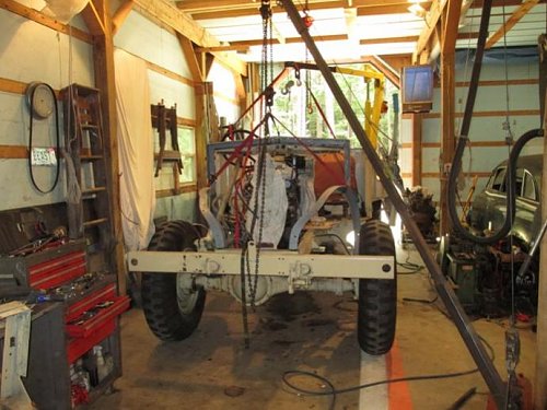

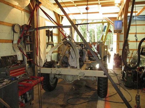

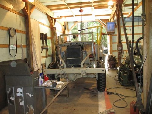

New Cab Frame in place
Name:	C60l Cab Work 055.jpg

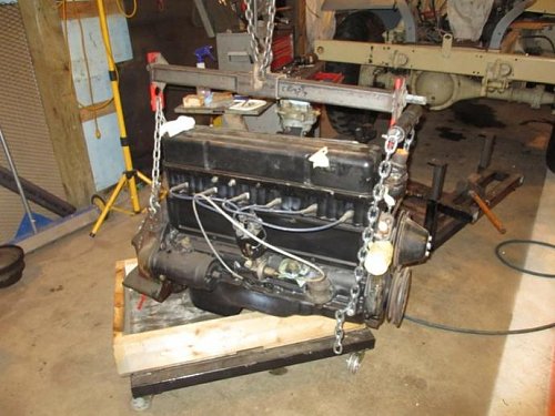

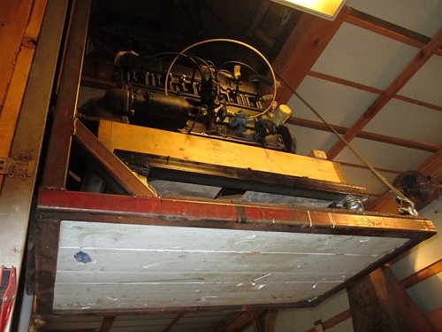

Bringing the 235 down on the elevator from the loft of the barn
Name:	w C60l Cab Work 057.jpg
235 Hanging on the leveling bar getting it ready to lift up to put in on an engine test stand.
Name:	w C60l Cab Work 059.jpg
If you have any questions about how something is mounted on a Pattern 12 Chev now is the time to ask.

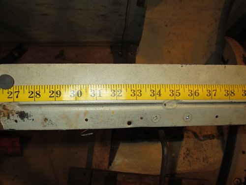

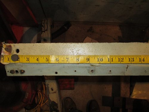

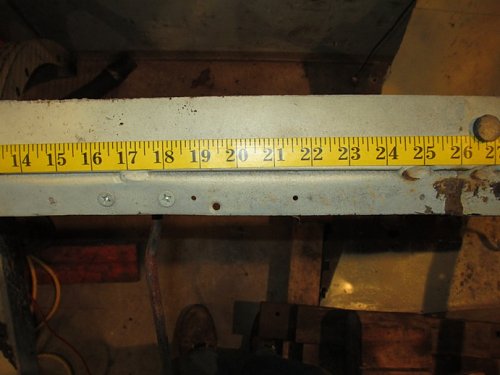

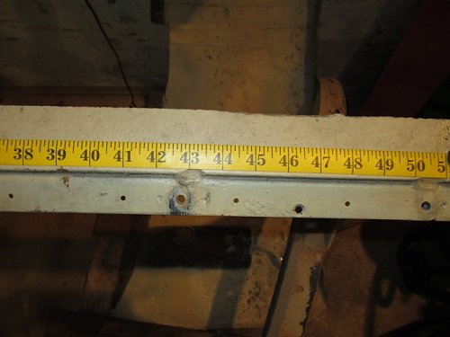

Default Question about telling Pat 11 from Pat 12 Cab Frame

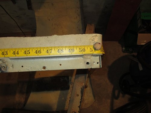

Hi All
This post is in response to a question asked by Alex van de Wetering who happened to send me a message asking about part numbers or a way of telling Pattern 11 from Pattern 12 Cab Frame.
His message came in the day I was swapping out cab frames. I have not found any part number stamped on the cab frames. But it occurred to me that one of the major differences was Pat 12 have a hinged hood so the holes for the hinge and there location should be a give away.
So the photos below are looking down on the top rail of the cab frame, with a tape measure stretched from one end to the other.
Name:	Pat 12 Cab Frame 003.jpg
The center of the top frame is at inch 26 the driver side hinge outside mounding bolt hole is 16 inches in from the end and the other 18 inches
Name:	Pat 12 Cab Frame 004.jpg
ID:	66091 Click image for larger version
Name:	Pat 12 Cab Frame 005.jpg
ID:	66092 Click image for larger version
Name:	Pat 12 Cab Frame 006.jpg
ID:	66093 Click image for larger version
Name:	Pat 12 Cab Frame 007.jpg
Alex I hope this is of help, because otherwise these are probably the dullest photos I have ever posted, not photo contest stuff.

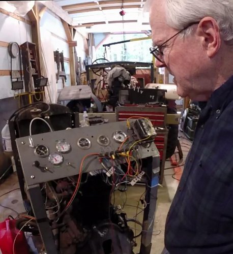

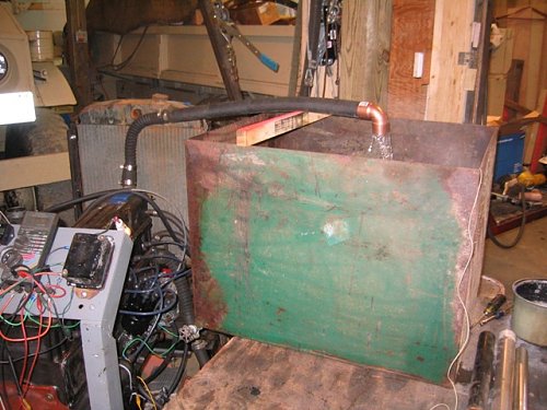

Set up the engine test stand with a large tank at level of the standard radiator so the water came out the top outlet and dumped into the tank with 22 inches of standing water in the tank same as the radiator. Of course with the thermostat installed the flow rate is control by temp and RPM. Results with the two water pumps came out almost identically so it probably the thermostat throat that controls the flow rate. The at 500RPM flow is 2-10 gallons per minute at 1000RPM flow rate is 8-20 gallons per minutes.

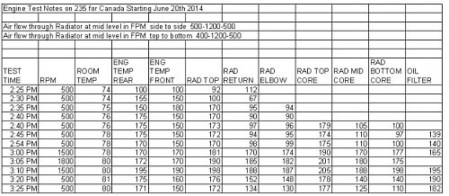

After two hour long test cycles to day with the 235 I'm getting strange results. I have two water temperature sensors one in the normal location at the rear left of the block and the other into the water pump housing. At 500RPM the engine seems to stablize with the rear reading 170F and the return reading 150F good 20 degree delta for the radiator. But when you bring the engine up to 1500RPM rear is reading 170 and the return is reading 170. To further confuse things though at 1500PRM the water going into the at 200-210F (read with IR gun) and returning at the bottom of the radiator 198-175
The other thing that was going on during these test was the air temperature in the shop went from 74-80F.
I knew there was a reason normally do engine testing and break in running in the winter heats the shop up nicely.
Will have to figure out how to display the data so you can take a look.
Phil, you won't detect any delta once the motor speeds up with the thermostat open, because the water passes through the radiator far too quickly to cool down measurably. At normal flow rate it's only in the radiator tubes for an instant, you'd need quite sensitive equipment to measure the temperature drop from top to bottom. The cooling system relies on the huge volume circulating every minute, so it only needs to cool down a few degrees through the radiator.
We can do a rough calculation based on your 8-20 gallons per minute result at 1000 rpm, choosing say 16 gallons per minute, which is 16 x 3.8 = 60 litres per minute = 1 litre per second. I don't know what the total volume of all those skinny tubes would be, but if we estimate it to be 1 litre, then the water passes through in 1 second. It just won't cool down much in that time, esp. stationary with modest fan rpm. Different story at idle when the thermostat is closed and you're only getting 2 gallons per minute flow. That's 8 times slower, which means the water spends 8 times longer in the radiator, ie. 8 seconds by this calculation. That would account for your 20F delta at idle.
Of course, the delta will also be greater at speed when you're getting maximum airflow. We can do a rough calculation based on a CMP at cruising speed, let's say 50 HP engine output. Petrol engine efficiency is about 25%, which means there's another 150 HP being lost in heat. About half goes out the exhaust and half into the cooling system, which means the radiator is operating at 75 HP (x 0.746) = 56 kW. That would heat your workshop nicely Phil, and it also explains why the engine cover gets so bloody hot!
56 kilowatts = 56 kilojoules per second, and since the specific heat of water is 4.2 kilojoules/kilogram/degree Celsius, and a litre of water = 1 kilogram, the delta will be 56/4.2 = 13 degrees Celsius. However...that's based on our 1 litre per second figure, ie. 16 gallons per minute, which applies to 1000 rpm. If the flow rate is 3 times higher at 3000 rpm, the delta will be one third, ie. 13/3 = 4 degrees Celsius. Also, if the volume of all those skinny tubes turns out to be 1/2 litre, the delta will be halved, ie. 2 degrees Celsius.

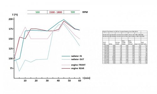

Here is the first round of data collection for this test
Name:	Test Data June 20 2014.JPG
I'm going to do one more engine flush on the radiator tomorrow then do another round of testing.

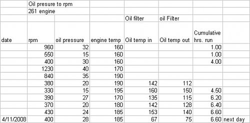

Hi Bob
Strange you should mention Oil Temps as part of the equation. When I was testing the 261 engine prior to putting it in I ran some long test on the engine stand hour plus one of the things being checked was the inlet and outlet temp of the oil filter that was mounted in the airstream from the fan.
What I was testing for was oil pressure drop as the oil and engine temp went up. You will notice that there is a significant delta temp across the filter from the cooling area of the big spin on filter.
Name:	261 oil pressure to temp.JPG
Once the engine was installed with the longer lines to and returning from the filter and the filter mounted lower more down in the airstream under the truck the delta got even larger. The cooling effect on the oil means that you have to drive the truck pretty hard for at least an hour to get the oil temp and the engine temp to equalized. If the outside air is much below 70F it never does, which means the valves can only really be adjusted in hot weather.
As to adding an oil cooler/ oil warmer wonder which would be better an air flow cooler or one that runs through the bottom tank of the radiator? But will over cooling the oil just add to the problem of vapor condensation in the oil not getting boiled out? Or is the internal air temperature through which all the oil must travel at some point get high enough to boil of the water vapor. But maybe that is why they have the thermostatically control oil cooler?

Now to Tony's comment on delta on the radiator at full throttle, believe he is absolutely correct if the radiator is at all undersized. If the radiator is big enough there will be a delta change and should be a delta. There is also the obviously, as Tony points out, a speed through the radiator at which fluid is moving to fast for heat exchange to take place. This gets into the problem of no thermostat no flow restriction may make an over heating problem worse. With the CMPs though I don't think we are at that point because the top hose is so small.
This afternoons work will be to use a radiator flush and do another long engine run to see if the temperatures change.

I'm rethinking my testing logic and data collection methods.
Phil, I think what you're doing is fine. That's really good data you've collected, it tells the whole story when it's plotted. You can see the thermostat opening at t = 10, then the radiator works perfectly for the next 20 minutes at idle, but when you increase the revs the engine temp starts to soar, giving every impression it would boil if you continued. Perhaps you could let it go a few minutes longer next time and see if it boils. It can't hurt the motor provided you switch off immediately.
There's only one improvement I can think of for this test regime, and that would be a coolant flow meter. It would be very useful to know what the flow rate is doing in response to RPM increase, because it would tell us if the radiator is partially blocked. The temp graph doesn't tell us much there, because although it shows a huge drop in delta when the revs increase, which indicates greatly increased flow rate, it doesn't mean a great deal if the baseline flow at idle is being restricted by the thermostat. We need to know absolute flow, not relative flow, and only a flow meter can tell us that. They're dirt cheap nowadays, eg $57 US for 1.5" diameter: http://www.aliexpress.com/item/Free-...572166866.html
On the subject of flushing radiators, I recall using a kit back in the '70s which had a tyre valve on the hose fitting, the idea being to introduce a burst of air into the backflush flow to help dislodge particles. I don't know if it's still done that way but it makes sense to me. However I only used it in a servo for routine servicing, so I don't how effective it would be on a problem radiator. I haven't had much luck clearing blocked radiators over the years, despite using some very savage chemicals at times. Last year I put a whole bottle of phosphoric acid in a blitz radiator and left it for a month! It was bright green when I emptied it out but when I stuck it back in the truck it made no difference. You'd think by now there'd be a chemical on the market specifically designed to dissolve that brown stuff that clogs radiator tubes. Unfortunately it seems mankind has yet to come up with a way to unblock long skinny tubes except by poking things into them. In that respect we don't seem to have progressed beyond the monkey poking sticks into ant holes.
I was amused by the Coolview thermostat, I thought only someone like me would think of something so weird! I love it as a dress up item and it would be very instructive to see a thermostat working, however apart from that I don't really see the value. My query would be replacement thermostats, ie. do they sell the thermostat separately or do you have to buy a complete new unit.
Look forward to your next data set Phil.

Hi Tony
Your graph came out giving more information than mine because of the way you ordered the data to be graphed. Did you have to type all this data back in because or did you capture from the picture? (Will add a photo of location of measurements)
Well this afternoon, did flush the radiator with radiator cleaner, because of the right angle filler neck you can not see in to see if it really cleaned. But what came out was nearly clear. The engine had been hot tanked when it was rebuilt so it was clean inside.
As to air burping radiator while flushing, yes I did this when back flushing the radiator upside down. Shop vac to what would be the in pipe water to the out pipe and a flex tube fed in through the drain cock hole with the engine upside down ran the water at full tap flow in and kept moving the flex tube in and out of the tank so that it would move the stream of bubbles around no crap came out.
Ran the engine for nearly an hour today. Air temp in the shop when I start was 80F/26C (hot day here) very quickly the shop air temp jumped to 90F/33C. Ran the engine for 30 minutes with the cleaner in then 30 minutes with drain out and cold tap water going into the top tank to make up what was coming out to clear the flushing agent out. Running the engine at 2000RPM it climbed to about 190F and on the water jacket sensors and about 205 on the top tank with IR gun, but no higher.
Interesting to watch the temp gauges with the engine not running but the blower fan still on the engine continues to circulate, thermosyphoning causing good circulation. (to insure some flow with the thermostat fully closed I have added an 1/8" hole to thermostat body.)
Was going to do more testing but by then I was pretty well cooked standing around in the hot air blast coming through the radiator.
Think the next step will be to finish the conversion of water pump from the low mount position to the high mount to match the original fan location.
More details on pump swap from doing it on the 261 http://www.canadianmilitarypattern.c...ifications.htm
Looking at these photos, it reminds me that I need to check the pulley sizes back to the original engine on the Pat 12 engine just to be sure that in the process of swapping out the original unusable 216 engine for the one that is in it now that I didn't in inadvertently mess up both the water pump and fan speed.
Ah the mysteries of CMPs.
Thanks everyone for taking time to read this thread and add thoughts and suggestions.

re: Your graph came out giving more information than mine because of the way you ordered the data to be graphed. Did you have to type all this data back in because or did you capture from the picture?
Something else I haven't learned is how to use chart functions on MS Excel. I'm still using the old school method - graph paper! Other times I just use plain paper and construct my own axes, which means using a ruler to mark scales and plot data, but for presentation I do it on MS Paint, using the cursor pixel position instead of a ruler. It means using a calculator to convert figures to pixel position, but I'm pretty handy with a calculator so it's a very quick method, esp. with my scientific calculator which stores data. I've had it for 20 years and I'm always using it for something or other, in fact I rarely leave home without it! It's a bit tragic, but I'm one of those people with numbers rattling around inside my head all the time! I daresay you can relate to that Phil. Unfortunately though I don't have the patience or aptitude to learn computer programs, and unless I use them regularly I soon forget.
re: Running the engine at 2000RPM it climbed to about 190F and on the water jacket sensors and about 205 on the top tank with IR gun, but no higher.
That's very encouraging Phil, hopefully it will do the job on the road.

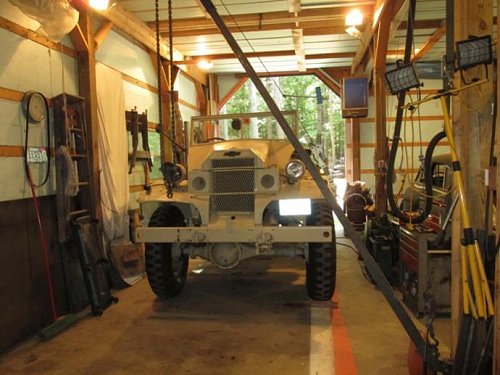

Default Nose Job Worked
Hi All
Well the nose job and engine swap worked, the truck can now breath and it doesn't seem to overheat. Took the truck for an extended drive today ambient air temp 29C or 84F and the truck never got much over 190F which is a far cry from boiling into the recovery tank which it did before.
Also now that the clutch completely disengages the truck shifts like a dream. The clutch problem was caused by a clutch disk that actually was sticky to the touch.
