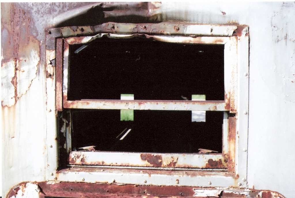

I will need to assign a W.D. number to my Ford 3 ton ambulance when I am finished the restoration.I see in Clives report that there are 2 sections listing ambulance numbers.A 5 digit and a 7 digit number.What would be a proper number to put on my 1944 Ford 3 ton ambulance and how can I pick a number no one else is using? I know there aren't very many restored ambulances out there but some are restored.Peter Fords CMP list may help but there are some overseas also.Any help would be appreciated.Thanks,

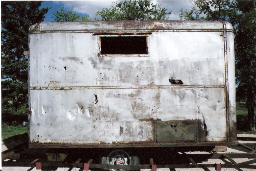

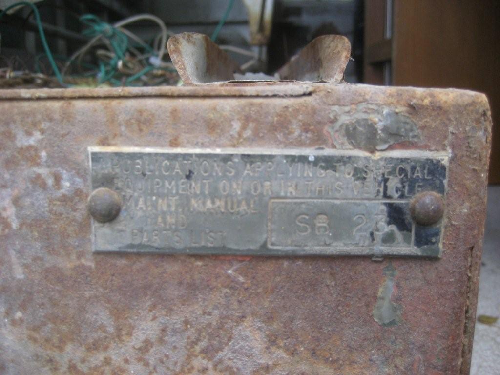

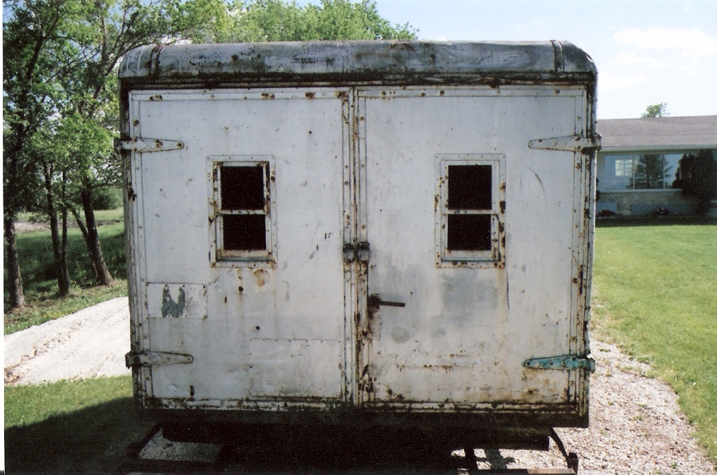

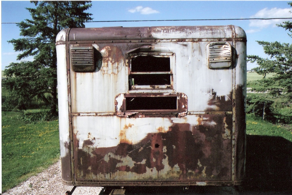

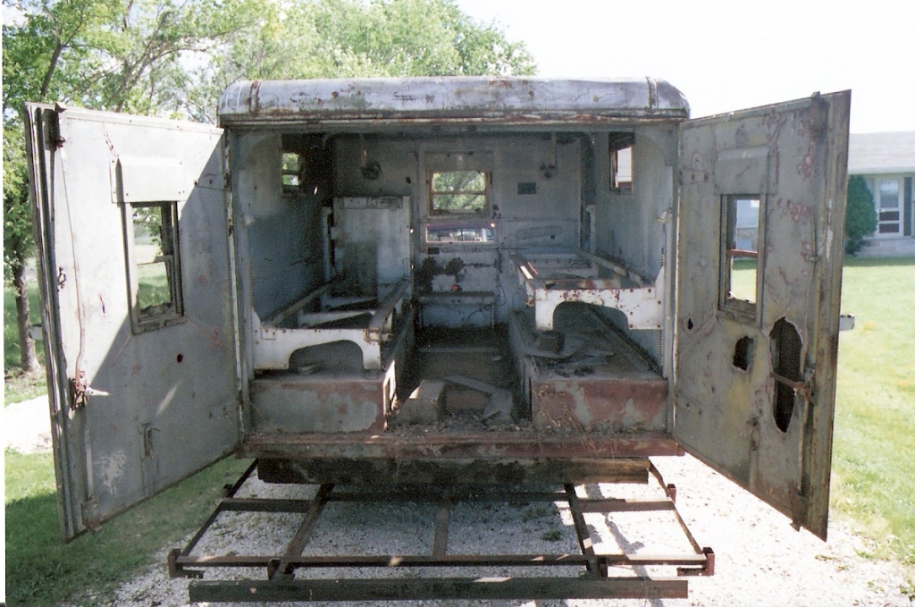

That would be great if you have photo's you can pass on to me.I have been slowly collecting what I can find on the ambulance and every photo reveals details I will need to make a proper restoration.I am particularly interested in the inside photo's of the ambulance box itself as I am missing the water tank and will have to reproduce this item and the heater is also missing.The outside of the box has flimsy can holders I will also need to study to reproduce and mount properly.On some photo's,it shows a rear step mounted to the frame I am interested in researching to see if one is required for my project.Any help would be greatly appreciated and it would be for my use only.I am also interested in finding the following publication for the ambulance box according to the data plate on the inside beneath the stretcher rack;
Thanks again for all the help,
Derk.
