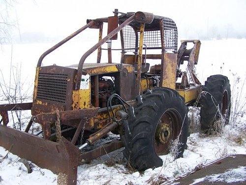

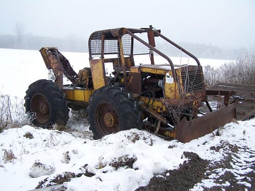

bought a log skidder to get the carrier out of the bush.
ID:	32675 Click image for larger version

Hey there Jon. You have the right couple of guys. lyndsey and i just bought the skidder. are you the fella that lives in the kingston area?. I may have picked up an other carrier. same deal. in the middle of no where. i will keep evryone informed
