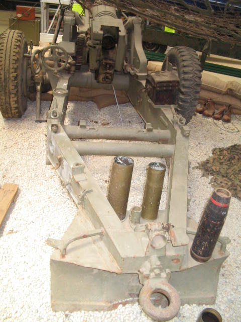

Old 07-12-14, 11:37
Posts: 14,975
Originally Posted by rnixartillery View Post
Richard, So sorry to drag up this old thread but did you ever find the pictures of the gun you restored ? I am trying to determine the shield configuration between the two modified 25 pdr's.I know one had the extra flaps in the shield in front of the wheels for the drag ropes and the other without ?
Don't be sorry, it's about time this thread was refreshed!
That one shown on Richard's site seems to have the standard width shield instead of the narrowed one. Result of a mix & match of parts during a rebuild program?
For comparison here is a front view of regular 25-pdr shield (left) and the narrowed one on the Mk.2 and Mk.3 carriages (right):
ID:	69598 Click image for larger version
See more and larger pictures of these two 25-pdr guns in my G503 album >> 25-pdr.
