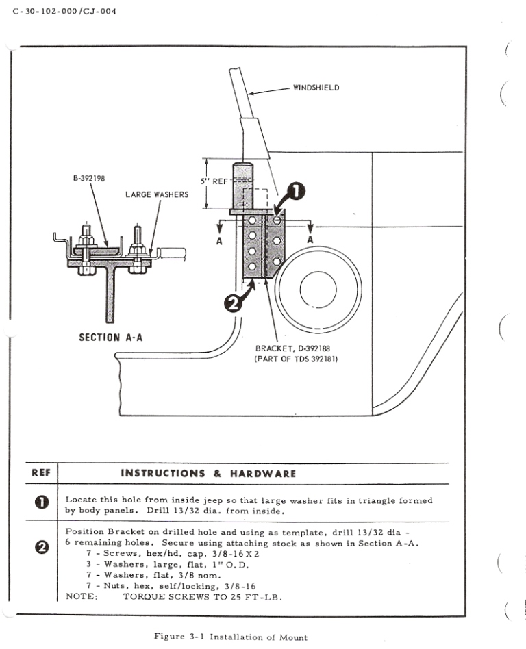

I have part of the cfto for mounting the gpmg mount to the jeep tub.I also have the diagram that shows the mounting of the ammo tray.The first design had just a side plate where a strap goes through and holds the ammo box to the side.Later they modified that with bending and fabricating a proper tray that the ammo can drops in.I used to have both on my M38A1 CDN 2.I don't know if you can blow the picture up to see it more clearly?
Hope this may help you.

Derk,
Thank you very much. The diagram is very helpful. It matches the one we drew up. The picture were a little blurred when I blew them up, but never the less helpful.

Sand blasted the swing arm and painted it today. Compared our drawings with your prints. Very Close. Ordered some metal and will start building the mount later this week. I would be intersted in the prints of the ammo tray.

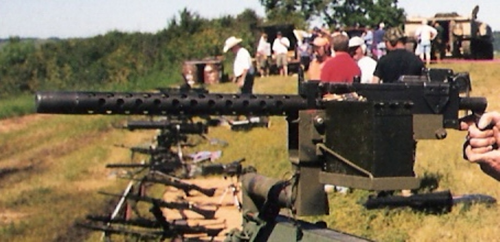

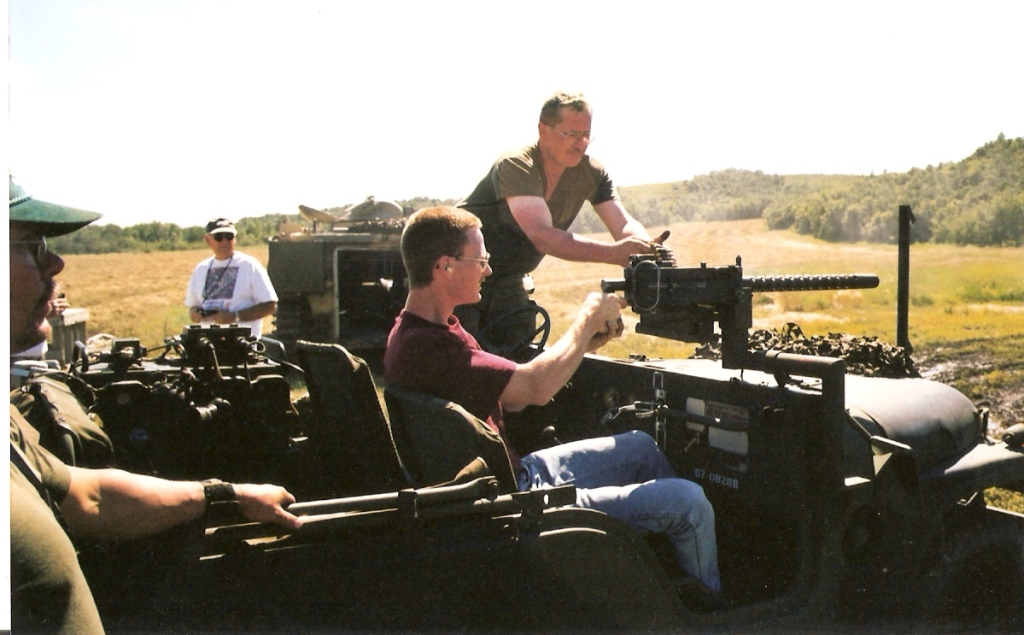

The closest picture I have of the tray for the ammo can is me actually firing the 1919 on my jeep at a Machine gun shoot in 1998.Hope this can help.
I just had to make sure I didn't shoot the wirecutter on the front bumper!

Thank You for sending the pictures. One picture is worth a thousand words. Your three pictures answered so many questions I had not even asked or was afraid to ask.

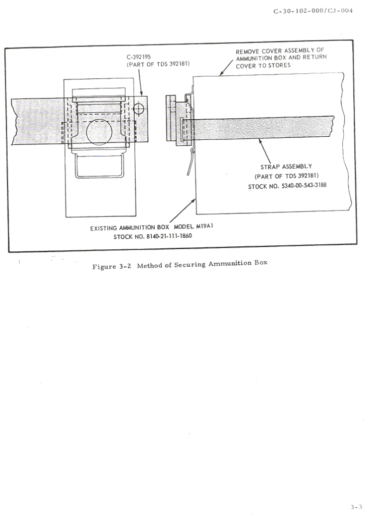

I am not so sure the ammo tray was an official modification, but rather was a locally produced item. Normally just an ammo box was secured on the arm by a small cargo strap. There was a modification later on with a couple U bolts and some canvas bags to catch the spent brass and links.

The ammo tray on mine was purely there out of neccessity and was home made by me. My GPMG is converted to 8mmX63, which comes on cloth 250 round belts which would not fit in the 7.62 ammo can, so I made up the tray to accept the swedish cardboard box. As I mentioned previously, there were the odd trays around, but they were a local thing. The .308 ammo can locks into the existing arm quite nicely.
Here is a quick snapshot of the CFTO detailing the modification for the link and cartridge catching bags. The bags are found in various surplus stores (I last saw them at prefair in Montreal) and I think Brian Asbury may have had them listed at one time as well. I have a set or two, but have never got around to making these items. Quite frankly, they filled up too quickly anyway.
If there are any other details you want to see, don't hesitate to ask. I realize this one photo may leave a few questions.
