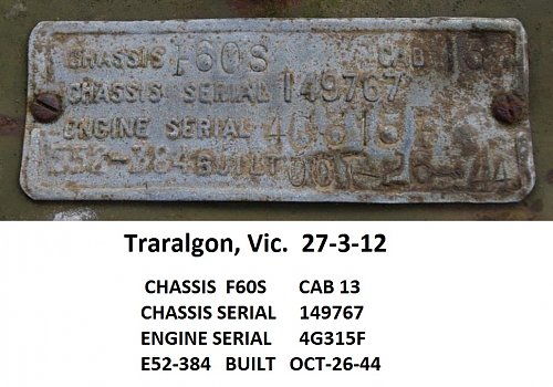

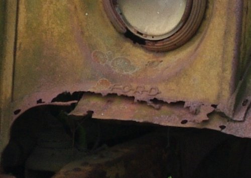

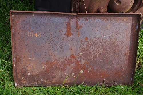

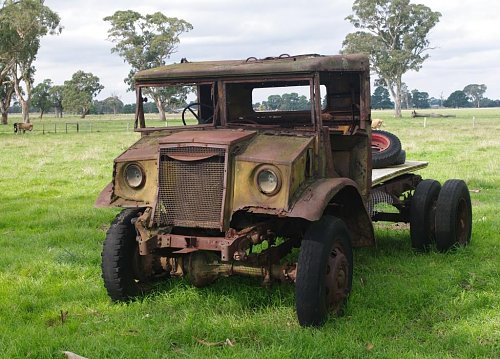

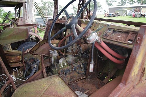

Posts: 953
Very occasionally we find early dash on late production F60S, invariably in combination with 1943 -FORD- front shell.
Here's an example from late '44. Front shell is 1943 (bonnet was still attached before I broke it off to photograph).
