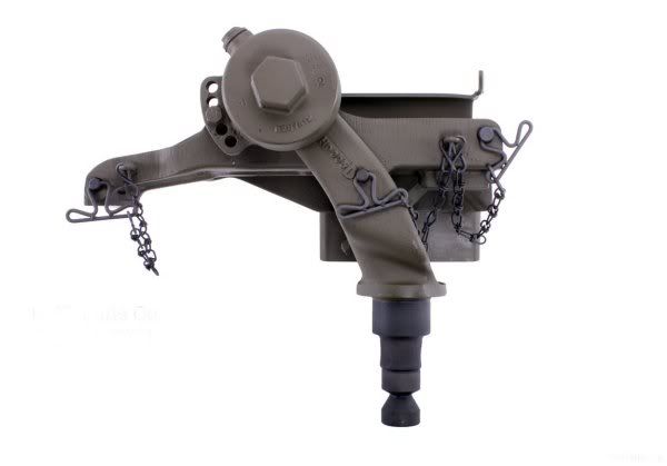

Would this be the correct 50cal cradle mount for this Sherman? Thank you in advance.... Harold

Not for a WW II time period.
This is a post war cradle.
It will work but will not be correct.

Does anyone have any detailed picks of the correct late war 50cal cradle and pintle that would be correct for this version of the Sherman? Thank you in advance.... Harold
