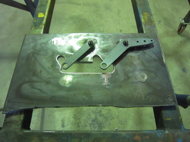

Hi all, update on carrier project. I have completed the hull which is now ready for the grit blaster so I thought I'd pull in another one and prep the hull as well.
Colin.

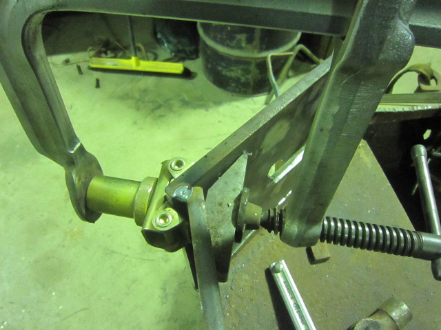

Pulling things apart, getting the cross shaft out. The replacement steel is cut and ready.

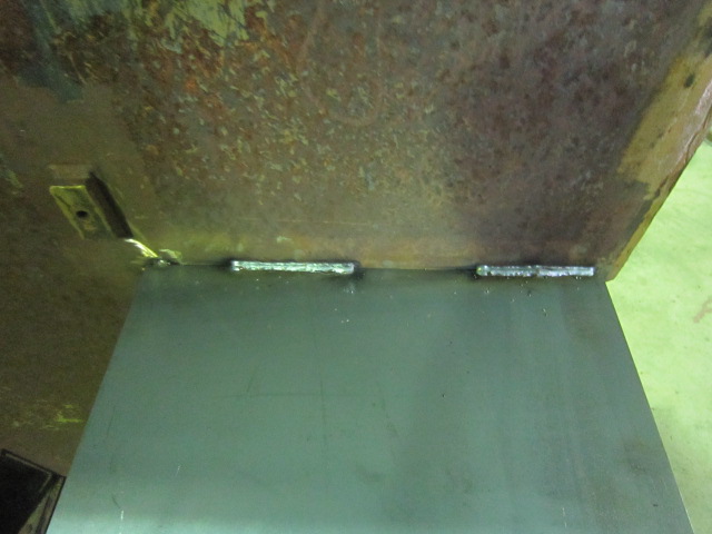

I got a bit more done with a few interuptions today. I found a crack in the floor so I did a repair before I put the side on. When I build my shed I put a overhead gantry in. When doing this type of work on your own it's like having an exrta couple of helpers at times. There are 2 independant ones up there which give me a lot of flexability. they travel 12mtrs x 4mtrs as the last photo shows.
Colin.

All brackets finished, small screw blocks done and I welded them all in location prior to welding the side plate on. Thats just about that side almost complete.
Now this probably raises that age old question again. How much of the original needs to be there before it's a replica. There was a fare amount gone from this one but I still class it as original.
