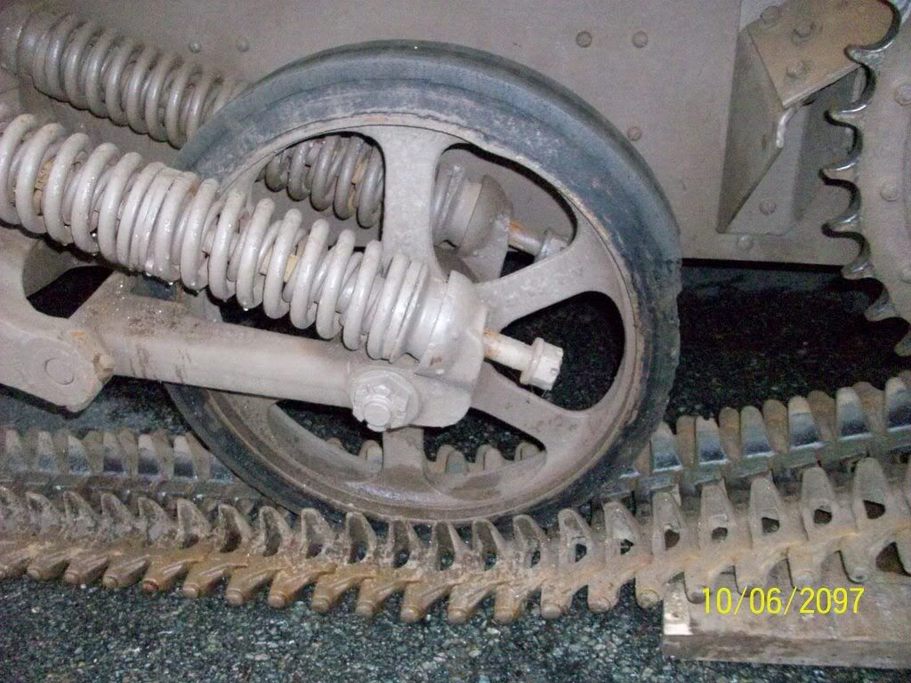

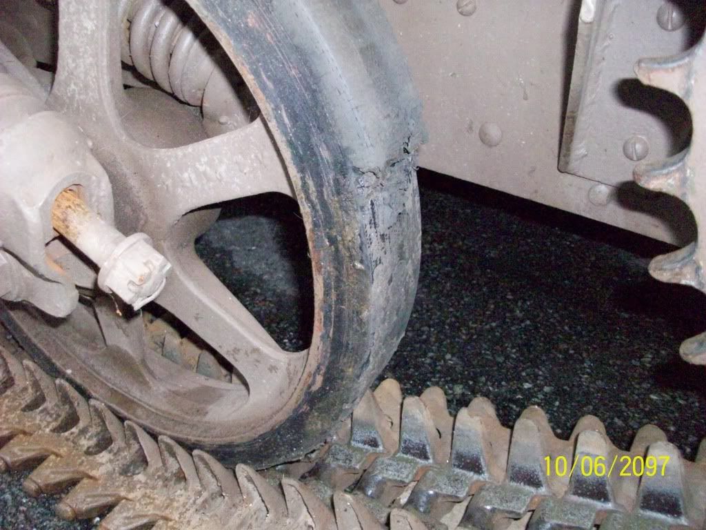

My pal Mikes Carrier. He sent me these pic's to pass on as too, Do Not re tread your carrier wheels in soft rubber. Heat, Friction, Dirt, wetness will destroy the retread, as you can see. Aidan

I would never have even thought to retread carrier wheels in soft rubber. The weight of the carrier alone would cause the rubber to compress and thus "bulge" out and rub against the track horns considerably. This in itself would quickly destroy the rubber I would think. Why did he re-tread them in soft rubber? Was it a money saving exercise or did the person that re-treaded them do it with the incorrect material?

looks like it was incorrect material, all of his wheels as I have Noticed are in retread soft rubber, about 1/2". these were done before he bought his U. carrier. It felt to me it is hard rubber under the soft. Aidan

Looks like someone made normal wheels from spanner wheels.
