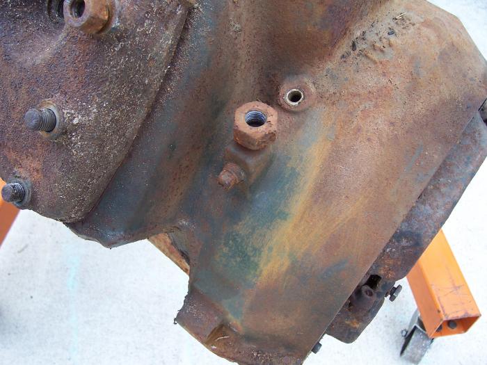

There might have been more than one color since the first engines were different than the later Mercury type which was a little more powerful. A few shots are attached of the Mercury pattern engine which matches the same color as the pulley and heads that I have.
The pulley on the other message is darker looking from 65+ years of NOS dirt. One of the engine shots was taken after brushing and wiping it down with oil on rags so it has a brighter and more glossy look with direct sunshine on it. The other shots haven't been cleaned up. You can see how dull it looks in comparison and could pass for a blue/gray shade. When cleaned and oiled, it looked like the more glossy shot of the front of the engine.

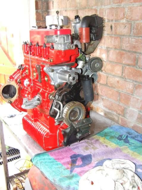

I am just going to throw this out there, but what about Rally X red :-
it is a proven fact that red adds BHP to any engine this one being my last engine build a full custom 1380cc A series with T3 turbo charger pushing 20psi boost and producing 225 bhp at the crank.... kinda makes ya wonder what they did wrong with the large CC V8's we have in our carriers
Hope i have tickled some of you

Was finally able to dig out a spare pair of T-16 engine heads that I've had in storage down at our ranch in South Texas so that I could shoot photos of them to show the original color. These were NOS but show a little North American shade of rust on areas where the head bolts and water hose go.
I didn't know what I could put beside them to show standard green and blue for comparison. But the postal boxes they are on do have some blue printing which is in the shade range of Ford/Mercury blue. To me the color is almost the same shade as the rifle green used by the Rifle Regiment if that helps.
Either way, it is the same color as the NOS WWII Ford V8 water pump pulley I'd posted closer to the top of the message thread.

Well Ford Dark Green it is then, I bet we are just scraping the surface of a deep subject, I may well contact the Ford Archive in the US, they have helped me out before. I am interested to know if Ford shipped Merc V8s (like the T16) to the UK or only ever the Ford V8. To be honest I'd rather have a Merc as they have more poke
