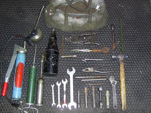

Hi Richard,
I believe the round can to be a Ferret oil can. Have one with my Ferret. Have a look at the attachments obtained from Ferret-FV701 website.
Name:	Ferret toolkit.jpg
ID:	40809 Name:  quartoilbottle_small.jpg
Possibly also used on other vehicles but no knowledge of that.
