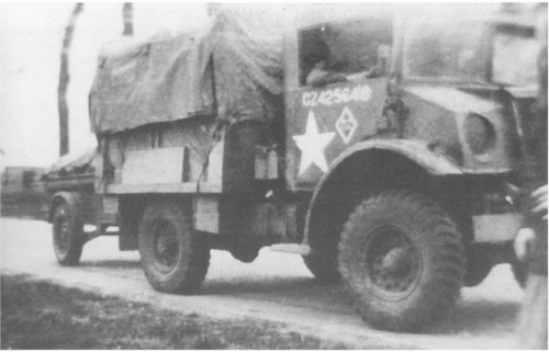

Here is a picture of a US-built 10-cwt trailer towed by a 15-cwt truck.
Originally posted by Hanno Spoelstra in wartime CMP F15A pictures
Reportedly, this is a Royal Canadian Dragoons vehicle which was pictured at a place called De Blesse. Census number seems to be CZ4256418, if I read it right.

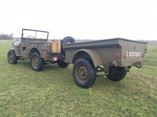

Here it is...
Will stencil the correct number next weekend...
Only thing left is better tires...

Thx Eric! Stencilled the number last night...
78560153_3206196059454439_6781485942835249152_n.jpg   75614007_802947900142238_3441208813523304448_n.jpg
