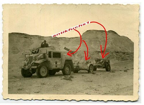

The same seller has a photo of a FAT with limber and 25 pouder in German management, on EBAY also:
Name:	GERMANY_Fahrzeug gepanzert aus England in Afrika_antikfuchs-ebay_May2011.jpg
1940 BSA M20
Old 17-05-11, 00:13
David_Hayward (RIP)'s Avatar
former Resident Historian
Posts: 3,841
Default Fat
Is that a CGT judging by the round ventilation holes? The likely Demands that would cover its delivery are either S/M 2020 or 2028...some of which latter were supplied to the AIF. FGT candidates are S/M 2020 as well.
