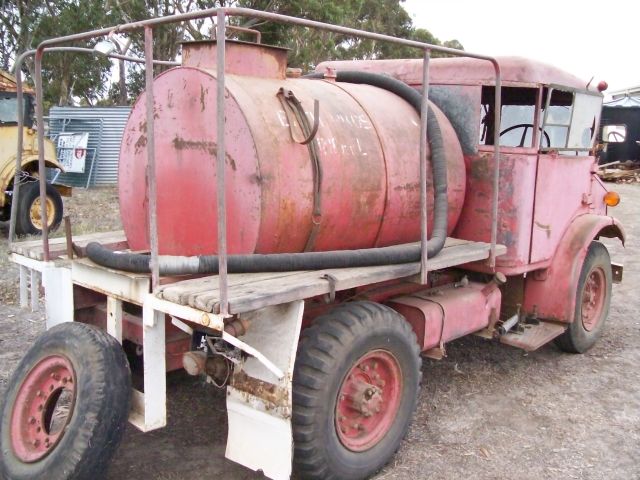

I have just purchased a shorty Ford F15 4x2 Blitz, number 13 cab.
It was last registered for road use in 2007 and on the sticker it says it is a 1941 Ford. I thought #13 cabs were 1942 or later. So my question is when did Ford begin production of the #13 cab. Did Australian production start at the same time as Canadian?
I don't have a chassis number yet and the data plate is missing.

OK, let's see some pictures then!
1941 is wrong. We didn't have cab 13s until 1942 as far as I'm aware. Is it a Canadian or Australian production vehicle? We had both types.
What's it's recent history as far as you know, Ryan?
Sounds like a nice purchase.

No Hanno it's not the Broken Hill Blitz. That would be good though.
Keith, this is one that was just up the road from me. Been in the same family for decades. Been a farm fire tender. Double springs on the rear.

Default Nice one, Ryan
Originally Posted by rynoki View Post
Thanks Jim.
Is that a small radiator I can see? It looks like one I saw many years ago in a newspaper article. I think that one had a Holden motor.
Going by the roof it's Australian production.

Thanks again Jim and David. When I get the chassis number it may shed more light on the matter.
keith you are correct about the smaller radiator. It has a Holden 179 engine and holden gearbox. Do you still have the picture you saw in the newspaper?
