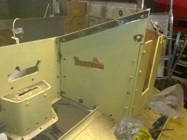

just been looking at some of Shauns pics of his front armour and his does not seem to have two rivets above the steering box to hold it on.... i have then gone through loads of carrier pics to find some carriers have the extra two rivets and some dont ? anyone any idea's ? i know shauns armour is original so its correct... just before i weld up the two holes i drilled !
if you look inside the carrier at the frame rail which runs along the top of the steering box armour, its there... they are there on Mk2's but not on all mk1's wonder if my steering box came from a mk2 ?

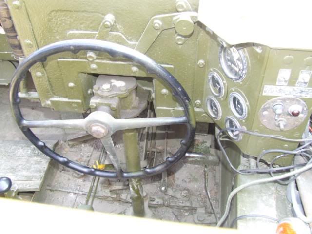

Hi Rich, That steering box I gave you is from a Mk2 British Carrier, I would leave the holes in as they are used for mounting the drivers steering guide vane on later Mk1's (Possibly used on Mk2's??).
The pic is a canadian 1943 mortar carrier.
kev.

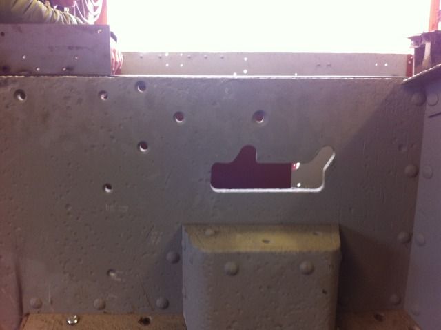

AHHH Rich, just realised you are talking about the two holes on the front drivers armour plate, I think they are counter sunk rivets in the two holes as the rivet head needs to clear the vision slot sliding armour glass when fully down. I will check on a carrier but i think you will find the rivet heads on the inside on the angle iron aligned with those two holes.

I've just checked, there are on the early carriers but only visible on the inside. This suggest Kevin was right and they're countersunk holes.
Perhaps the ones visible in your photos are replacement ones?
The earlier carriers don't have the driving aid on top of the steering box according to my info.

Yes they are there, and as Ben says, the holes are countersunk with a flat finished rivet

Richie, While i was working on the Mk1 tonight it does have th 2 rivets as the guys say.

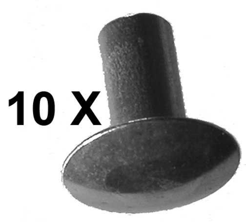

Lynn i have to pick the gun up from my mate but will post images up... its either a 2x or a 4x gun but more than up to setting a 3/8ths rivet.... truss head is also known as pan head etc etc Sapphire products (where i get me rivets) call them truss head.... basically the head sets like the cap of a coach bolt.. i have no doubt there are zillions of other names for it.
this is a truss head (already formed)
