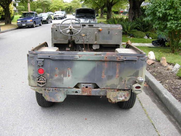

The small little tit that was soldered in the light bulb holder that touches the centre of the bulb is this removable as well or just a ball of solder? #2 pic
All the stainless screws broke on the pass side rear light not so on the drivers side. I was going to replace the pass side with a three bulb lens so I can have two brake lights. One brake light on the west coast confuses our newer drivers...they think you are signaling to the left every time you brake.
So if I can drill out the screws I'd be looking for the top two light guts and the lens. Or a whole new three bulb light...?maybe easier eh?
Now not sure about the lights either in the 3 light there are tow lights on the Top... a brake light to the right and the other one the left is...? rear tail light?non balckout? wasn't working and could not get circuit to work. #3 pic

here are the pics to show you the lights.

Re the two upper bolbs, the smaller (#623) bulb is for the running lights (should be wire number 21 powering it) while the larger (#1251) bulb is for the brake light (and turn signal if so equipped) and is wire circuit number 22.
The modification by the Cdn army was to add a single filament light unit on the right side of the Jeep on a separate bracket. The lamp unit was similar to that found on the railroad crossing arms. However, your best bet is to change the BO tail lamp assy for the same assembly that is on the left side. That would mean you would not have a BO brake light, but if you really wanted one you can install a lamp unit similar to your front BO marker but with a BO brake lense.

I have the light that you said was the mod by the Can forces (re the pic) is this the light? It looked so hokey when I bought the Jeep I thought for sure it was a farmers adaptation! Sorry farmers! Is this the light you described?! Ha ha ha.
I'll try the pry method and clean the lens and a repaint the Black out drive light. Yes maybe a totally new light body. I am not too too worried about not having a rear Black out brake light. The 67 I had had just that set up with the two bodies the same and the one added rear smaller black out like the front markers. Maybe I'll put the railroad back on ha ahahahaa!

That light is close to what I remember as the Cdn army modification. I think the originals did not have as thick a body. Problem with that light is it is a single bulb, so you will not have a running light on that side. A similar light is available with a two filament bulb with (a 1157 type bulb) but you would have to find the two filament bulb in 24V, which, while they exist, is not that common.
Note that when I say "two filament" I mean a bulb with two separate circuits inside it. Many 24 volt bulbs have two filaments, but only a single circuit. The bulb you would need would have offset pins on the side, and two contacts on the bottom.
