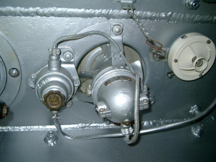

Default wanted Turret fan
Hi
The restoration of the Humber is going really well now, but we are looking for the fan unit that sits in the turret.
I have attached a couple of pictures of how it looks.
