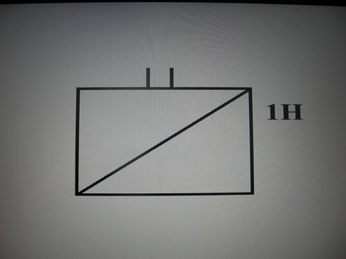

Hi Chris:
You want you tac sign to look like this:
Cheers! Mike

Thanks Mike, how thich should the lines be for the tac symbol?

The lines should be about 1/2 an inch thick all around.

The "Recce" tac symbol provided is incomplete...Infantry units used that symbol. Armoured units had the track symbol in the center added to denote an Armoured unit rather than a Grunt unit. This would always be on a Recce vehicle Reserve or Regular.

My own experience is that the recce tac sign was used on vehicles only by recce units. Inf recce platoons would have the battalion level marking on them not platoon level. It is my impression that the tank track symbol was jealously guarded by sub-units with Lynx and the "plain" recce symbol was used by militia regiments, however, as Ed has noted it was a time of liberal interpretation by unit and bde commanders so there are lots of variations!
You absolutly right that all the M38A1s came from the factory painted semi-gloss OD. The cam paint was added starting late 1975 or early 1976 at the unit level. I remember my Warrant at the time handing me a book of drawings (I still have the book somewhere) and a bunch of chalk so I could go out and mark the trucks to spec. I got in sh*t if I strayed more than three inches from the drawings! We did the unit's trucks (71 Bty, 26 Fd RCA) over a weekend. All hand painted with brushes!

Cross brace for cavalry (check),
No oval for tracked recce (check), and
Missing two small circles underneath for wheeled recce (yawning chasm of absence).

Gents, this symbol is not a wheeled or tracked based one, its based on the task performed. When the Coyote replaced the Lynx the tac symbol did not change since the task did not. And since we no longer have actual Recce Regiments which could use the pure Recce symbol, just embedded Recce Squadrons in an Armoured Regiment, this modified symbol is appropriate.
As a "Recce Dog" in the Strathcona's we taught the Militia jeep Recce every summer. This started during the M38A1's final years (and the end of the '74 pattern jeep) with the switch to the Iltis. We used to paint out the tac symbols at the beginning of the course (they were not worthy) and then upon successful completion of their Recce Crew Commander's course they could paint them back on.

Chris; look for photos of 1H jeeps from the time but if the oval makes you feel good go for it!
The little wheels underneath were never used on vehicle tac signs just in map marking.
