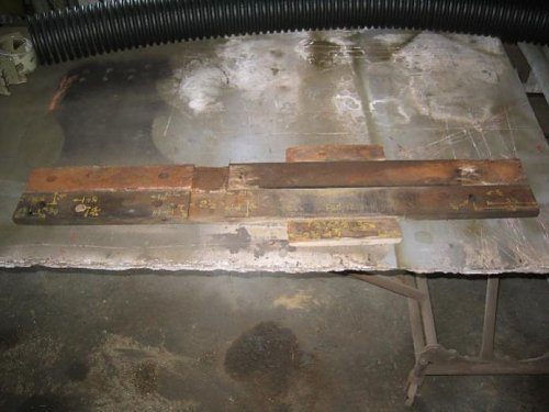

Default Photos and Measurements
Hi Alex
I've upload some high resolution pictures of the Pattern 12 wood spacers from my 1941 Pattern 12 C60L to http://canadianmilitarypattern.com/M...0Up%20Link.htm please note these are fairly large photo files so they may take a time to open.
If this is missing a detail you need please let me know.
Here also is the drawing for the wood blocks from under the seats. The passenger side uses 1 1" thick spacer the under each seat rail and drivers side uses 2 2" under each rail.

Now have access to my wooden floor spacers.
Measurements from Phil are almost identical to the one I reproduced.
I used white ash....oak would be good also. Wood should be painted with thinned out oil paint..... two coats...... make sure to get paint in the wood fibers of the drilled holes..... these holes tend to hold water/humidity and greatly contribute to thebolts rusting and the wood to decay.

on my truck there where 3 planks of about 2cm thick and 6cm wide under the floor, so I used the old ones as template. they had the same lenght as the floorplate, I mean from front footbord to first cross member (just before end of the plate backside) and then across the width of the chassis so you have a U shape of wood. there where no blocks on mine.
sorry I don't have the old ones anymore, they where to bad. (see my thread, No 100)
hoop this help a bit.
cheers jaap
