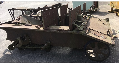

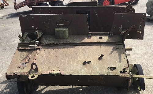

Folks, Is this the earliest Carrier in existence?, precedes, Bren, Scout or Cavalry carrier. Featured in Nigel’s Vol 1 book

Hi Hanno, Yes it is, one of only 14 made according to the book, will look for some date stamps but built in 1936 - 1937 I think.

Where had that been hiding Kevin? I would have thought they were obsolete before WW2 even started!

Hi, It had been saved by a gentleman many years ago and now I have it I’m going to restore it, still has its engine, gearbox and radiator in. I’ll have a proper look at the CMM number to see exactly what it is, but I understand from reading Nigel’s book several of the 12 or 14 were modified for development purposes, this one appears to be still in its original configuration.
One interesting point is the front idler is mounted lower than the later carriers.
