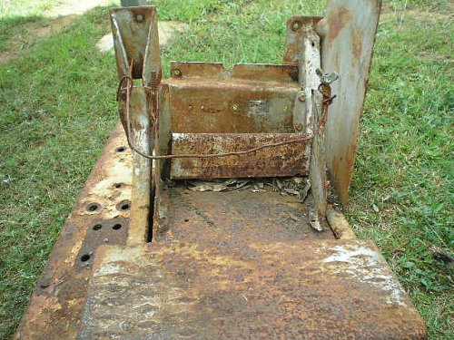

It was a good Melbourne winter project when it is too cold and wet to be in the shed. Not exactly Queensland weather! I therefore could afford to put a bit of time into it.
I have attached a few more close up photos of an original holder, corner bend, stud plate, and lower retainer plate attachment to help those who may fabricate one from scratch. I could not attach them with the plans due to exceeding uploads.
Many thanks again for your help in getting the ball rolling for me on making one of the parts I have been seeking for a long time.
