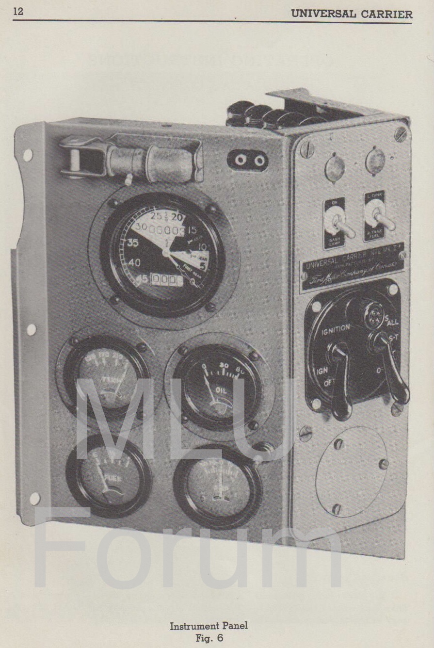

Although there's a decent amount parts with it, first job is to figure out what I've got exactly. I'm still very new to the world of carriers, but am I right in thinking they would never have had a 21 stud engine? Also is that mk1 uc dash?

Originally Posted by DomStokes View Post
Thank you all.
A few more photos, . .
Dom: greetings! On behalf of the universal carrier folks here, welcome to MLU Forum.
You asked about your dash.
The Windsor MK-I* dash is similar to the C31UCW NO-2 MK-II* dash, except the ammeter and switchboard. The switchboard looks the same, but is specific to the WC49 series. You can identify it from the part number burned into the back. Don’t be mislead by the images in the Windsor manual.
Here are some dash images for comparison . The C01UC MK-I* dash is the later (3rd) model. Quite distinctive with the engine start push button.
A factory engine in the Windsor MK-I* is a 95hp unit, 24 pin heads. Electrics are 12v.
