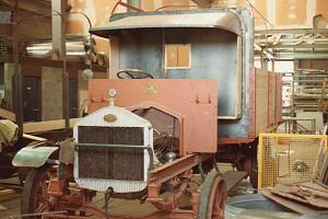

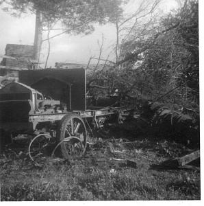

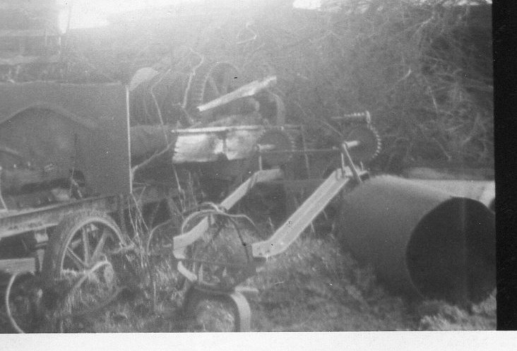

This is what I first saw way back in 1971 at the rear of A.W.Smith & Sons P/L Leongatha Vic. Aust. There was a large ship’s winch behind the driver’s seat for winching logs in the bush. This winch was driven from the final chain drive pinions on each side after the truck had been driven to the work site and the chains linked up to the winch. Bert Smith the owner wanted to keep the winch so that had to be removed first.

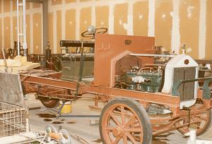

The chassis had a 3” sag in it between the front and back axles so the chassis had to be completely stripped down and straightened. This was achieved with the assistance of a track breaking press for bulldozers.

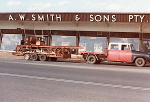

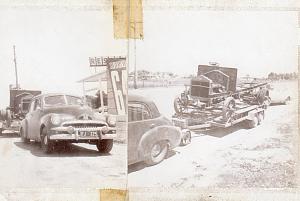

I brought it home on a tandem trailer behind my trusty 1956 ‘FJ’ Holden. That is something you could not do today, 3.75 tons behind a car weighing just over 1 ton. Petrol at Rosedale was 64cents a GALLON. ($0.14.2 cents a litre)
The chassis stripped down for straightening and sand blasting. The tyres were pretty sad.

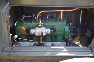

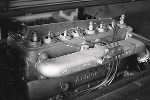

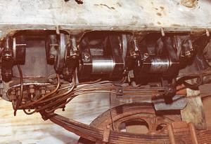

The Albion engine has a dry sump system invented by Thomas Blackwood-Murray the founder of Albion. The oil goes to the 5 main bearings and the 4 cylinders. It then drips off the main bearings and collects in slinger rings which sling it into the big end bearings after which it is thrown all around the engine. The oil should be run off at the end of each day according to the brass plate seem above the exhaust manifold.

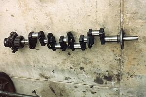

The crankshaft was in excellent condition but missing the governor. I found one as well as the magneto cut out switch in Toowoomba QLD.

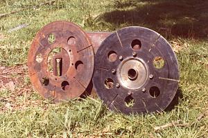

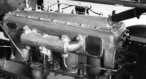

The clutch plate was beyond repair as the lining rivets had ground well into the plate. The Albion has the linings on the flywheel face and the spring plate with a spinning disc plate, the opposite to todays practice. Where do you get a new clutch plate these days? Well, you cut one out of a circular saw blade which, I might add, are extremely tough but designed to carry heat without distortion. It is a lovely clutch to use.

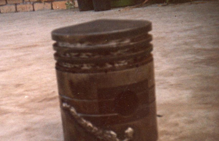

No.2 piston came out in 3 bits, so it was a case of welding it back together and hand filing down.

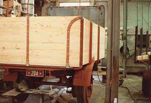

I the commenced the building of the body using the body builders blueprints I received from the Albion company in 1971.
ID:	79983 Click image for larger version
ID:	79984 Click image for larger version

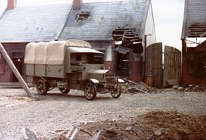

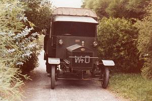

In 1983 the Albion was used in the first big Australian TV production, a 10 hour story called “The ANZACS” here it is on set in a ‘French village’.

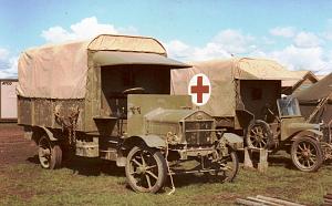

And also with a 1916 Talbot ambulance for company on site.

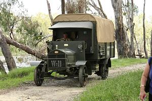

A vintage lane in England? No our driveway a few years ago.

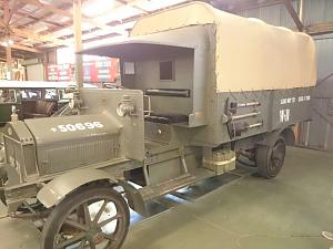

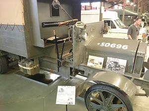

So where is she today, On loan to the Bandiana Military Museum where it has been for a number of years. She was on display at the Australian War Memorial for 3 ½ years before going to Bandiana.
We often get her out for a run and will see her for a belated birthday drink in a couple of weeks.

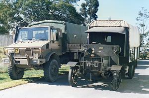

PS.. 361A was used to promote the then new Unimog on their acceptance into the Australian Army all those years ago.

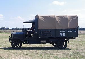

Hey, I know that truck!
ID:	80015 Click image for larger version
ID:	80016 Click image for larger version
Looks even more impressive in person.

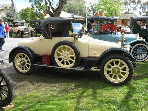

Bob, The 2 gallon cans go back to about 1908 or there abouts. In those days there were next to no service stations and you purchased your petrol from the chemist. The cans were the only way to buy it at that time and you will see cans on the running boards of many veteran and vintage cars.
Here is a photo of my 102 year old 1914 Talbot with a red can from the 'Big Tree Motor Spirit' company, a New Zealand company which imported motor spirit (petrol) into Australia in 1914.
Name:	Shep Rally 276.jpg
The cans are pretty well made and of a thicker material than the ones found on 1970's Australian army vehicles. They are almost identical in size. There are hundreds out there still from the early days. I have about 30 or so but not too many are of a military origin. The Vickers machine gun in WWI and WWII also used them for cooling water.
Regards Rick.

Hey, I know that truck! Looks even more impressive in person.
It's even more impressive on the move Tony! I recall my first encounter while driving through Corowa - upon exiting the roundabout my progress was blocked by a large green contraption travelling at an unhurried 10 mph. I sat close behind all the way to the caravan park, totally mesmerized by giant spinning sprockets and flapping drive chains!
Later of course as I became fully acquainted it struck me what a truly historic vehicle this is, and what a visionary project on Rick's part way back in the '70s, when everyone else was into jeeps! Congratulations Rick and HAPPY BIRTHDAY 361A
Name:	TONY2269 - Copy (2).jpg
ID:	80098 Click image for larger version
Name:	TONY2258 - Copy.jpg
