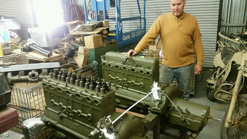

Restoration complete and shipped from Galveston,TX, to Antwerp where a Dutch buyer will collect it. It will live in Sneek, Netherlands, SW of Leeuwarden where there is a large Dutch AF Base.

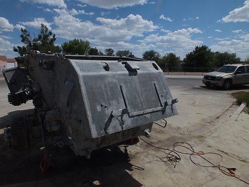

Restoration consisted of newly rebuilt engines and a host of NOS parts, all new cotton-covered wiring in correct braided brass conduit and new radiators manufactured in the UK. Turret and all mechanisms are fully operational with new cables and pulleys for the complex engine shifting to the transfer case. All new brakes, shoes, and hydrovacs professionally rebuilt. This vehicle was not a range target like so many others, no holes or damage. Because of the complexity of starting and driving the stevedores were not permitted to drive it on the RO-RO auto hauler ship (Arc Defender) and a specially constructed tow bar was attached to the tow loop lugs to permit them to use a tug to get it positioned aboard the ship.

Actually 2023 was pretty complete inside and unmolested except for dirty. I replaced as many items as there were NOS parts with those NOS parts and did a complete sandblasting in and out before painting and restoring.

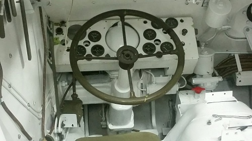

I never was able to get the oil pressure gauges for the engines on the instrument panel to work right....they got to full deflections always. Tried five different senders and never got a correct reading - always full scale. But I do know that the oil pressures are good because we tapped into the lines at the engines and used mechanical gauges to see 50-76 psi on start up. Perhaps you can help troubleshoot that - maybe there are correct NOS senders in Europe that are not here because of few staghound parts in the US...we searched for one for GMC 270s, bought them but they did not work!
We also found and error in the instrument panel to late to fix before shipping....the main ammeter works find and either engine generator shows a positive charge on the main - but the specific engine ammeters showed no charging. Rod brought a spare instrument panel over after the stag shipped and we discovered the two 0-60 engine ammeters had a triangular shaped board on the back of the meter with to 40 ohm resistors attached. Those meters were in the Keith spare parts from Australia but they are NOT CORRECT. The triangular boards need to be removed from the back of the two 0-60 ammeters andthe two engine wires from the generators hooked directly to the + and - meter terminals of the meters. Perhaps you can help Olaf and his mechanic with that. I will send photos from the spare instrument panel that Rod Shaver brought over in November after we shipped the stag.
Everything else runs and operates peachy keen!Leaving turret drive motor on draws heavy current and runs the batteries down fast...Also, leaving the master switch on drains the batteries since there are two resistors in line n the drive motor latching circuit and the dash that draw current whenever the master switch is left on. We put little magnetic plaques around warning to turn of master switch.
