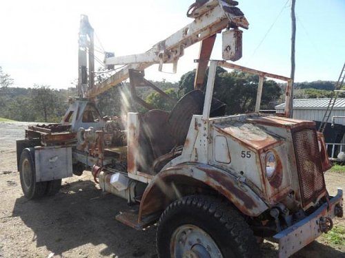

G'day everyone,
I have a mate who is chasing what I believe to be a Chevrolet RAAF Derrick Truck.
I have been trying to find some info on these but have come up with very little so far. I believe they are a mid-wheel base CMP truck with a large winch mounted behind the cab (above the chassis), all controls going to the driver, and a large crane - vertical mast with cable operated jib - worked by the winch. I believe the jib could not slew, but I may be wrong about this.
I have found a small picture on Rod Diery's site but he states that it is a derrick off a ship. I have however seen other photos of these vehicles. I was sure there was at least one on OldCMP but I cannot seem to find it now. It was taken from the rear and was in South Australia from memory.
Can anyone supply any pictures or information about these very interesting trucks?
Jared

G'day again everyone,
Thankyou to all that have posted so far.
I realise now that I should have been more specific as to what I was looking for. I was after the crane type truck that is in the pics that Keith, Rod, and Tommy K have posted. I used the word derrick as that is what I remembered them being referred to. But having thought about it, it really is a crane truck and the term derrick probably fits the fixed pole/tripod type crane the best.
The specification sheet posted by Keith is the same as the truck that is up here.
Now, some more questions:-
I assume that the winch lifts the load up, but how do you lower it? Can you reverse the PTO direction? Does it have some sort of brake mechanism you engage to lower the lifted load?
Thr Trinity Beach picture shows a hand winch(?) near the base of the mast. This looks to me like the mechanism for lifting or lowering the jib - before a load is lifted by the winch. Is this correct?
How does the crane slew? It looks like you just push it around once you have lifted your load - not nice if you are not on level ground.
There does not seem to be any provision for stabliser legs - can anyone see any in the pics?
What was the Safe Working Load/rating of the crane?
Crikey, that is enough for now! I welcome any more input about these cranes.
Jared

Hi Jared,
I think some of this might help you. The crane was designed to lift 3 tons originally, later increased to 5 tons by the addition of braces from the boom to the chassis rear and extra ground supports at the back as well.
Allan
File Type: jpg Trucks Derrick 1004 with 4.5ton conversion.jpg (79.8 KB, 85 views)

Here's some more to add. As you can see in the documentation, it is definitely called a derrick truck. Issued to engineers and the like, it would have been used, among other things, to load/unload the semi trailers that bridging platoons used to carry pontoons, bailey bridge sections, etc.
As for slewing control, there are 2 attachment points just behind the the tip of the boom. I think that simple ropes were tied here and used to pull the crane around.
Allan

Also on the vehicle data plate. The fact is these are the ONLY CMP derricks produced - the so called Derrick in pic 3 is not, repeat NOT, a derrick. The defining feature of a derrick is a pivoting boom which rotates around a vertical axis.

Hi and thanks Allan, the photos of the pages are fantastic, as I have finally got really started on this project and am making progress. Next week its chassis painting and from there we start the fun parts.
All the best and here are some old and some newer photos, I will take more as I go along for your interest if you like.
Cheers Malcolm.. Geelong Vic Australia
