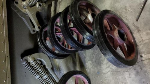

Hi all - it is quite simple. Firstly identify an industrial rubber facility and get a mold made using a wheel as a template. My mold cost about $3000 to make and what happens is that the stripped rim is placed in the mold and then rubber is molded to it under a 600 ton press. My rubber has a Duro rating of about 75 which is more than adequate.

the rim was stripped and they moulded polyurethane on it,after that it was machined to make it round.
the normal rubber is about 85 shore,the polyurethane is 80,that is similar too 85 shore rubber,so they told me.

Roy; I don't turn mine
they come right out of the mold like the pictures
but I sure do not know how you can do them so cheap my material cost more than125.00 cnd. $ the best I can do is 200.00 without the time to strip and time removing grease sand blasting so mine work out to250.00 each if they are not clean and ready to do
The ones I redo are done with the same polyurethane that is used in stamping dies that will take approximately 1 to 1 1/2 million hits before destructing under full compression
