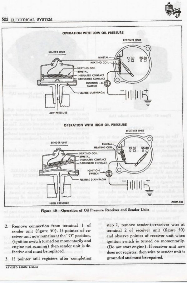

Here is a pic of how Henry set it up. One is variable and one is a switch.
(two terminal and one terminal, are wired in series)
I will also include a bit on the oil pressure sender. Be aware that there are two types of different resistance. you need the one to match your guage. The early one is harder to find. (I think the later one has "80" in a circle stamped on the face of the brass square.

That's great thanks Lynn, I have the oil sender which is getting tested this weekend (fingers crossed it works.... Bloody expensive they are !
I will try and trace down the second temp sender with the two posts on, I have the single post one in the head (again to be tested at the weekend)
50lb sender
80lb sender
Note that the 50lb sender MUST be used with a 50lb gauge, and the 80lb sender MUST be used with the 80lb gauge.

Is there anything on the back of the gauge to tell you ? I have not got mine to hand...

Correct me if I am wrong but the 50lb / 80lb pressure units go with their respective gauges , but also remember are there not two different types of oil pumps that can go in the sump , one high pressure and the lower pressure ones that the carriers use ( 50lb ). Macs auto in the States make repro sender units from ,I think Mexico , but these are for the 80lb units, so save your old low pressure units for reuse.
