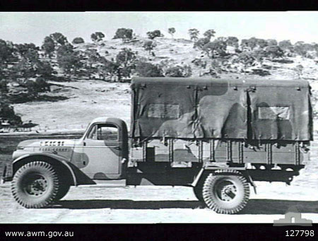

I'd hazard a guess at 1940 or 1941 Chevrolet 3 ton Modified Conventional Pattern with Holden manufactured body. further more accurate data can be obtained with the chassis and engine number.
Here's an original photo from the AWM
