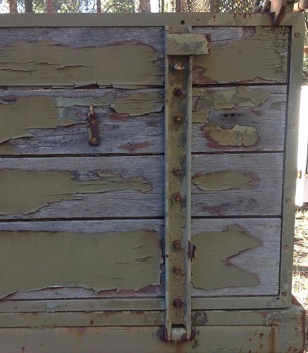

Your tray seems to be the same shape and design as mine.
http://www.mapleleafup.net/forums/sh...ad.php?t=21884
Is it 12 foot or 14 feet long? Ignore the Workshop cage, but the wooden sides and hinges seem the same.

The uprights look to be made from channel, with sections cut and welded in. Are yours attached with old-school coachbuilder's square nuts?
Looks like normal domed bolts with standard nuts, but remember this would have been rebuilt several times in the 40 years it was with the army.
The flat piece at the top is for the cage lock, so ignore it.
1942 Chevrolet C60L WO48 - (Workshop)
