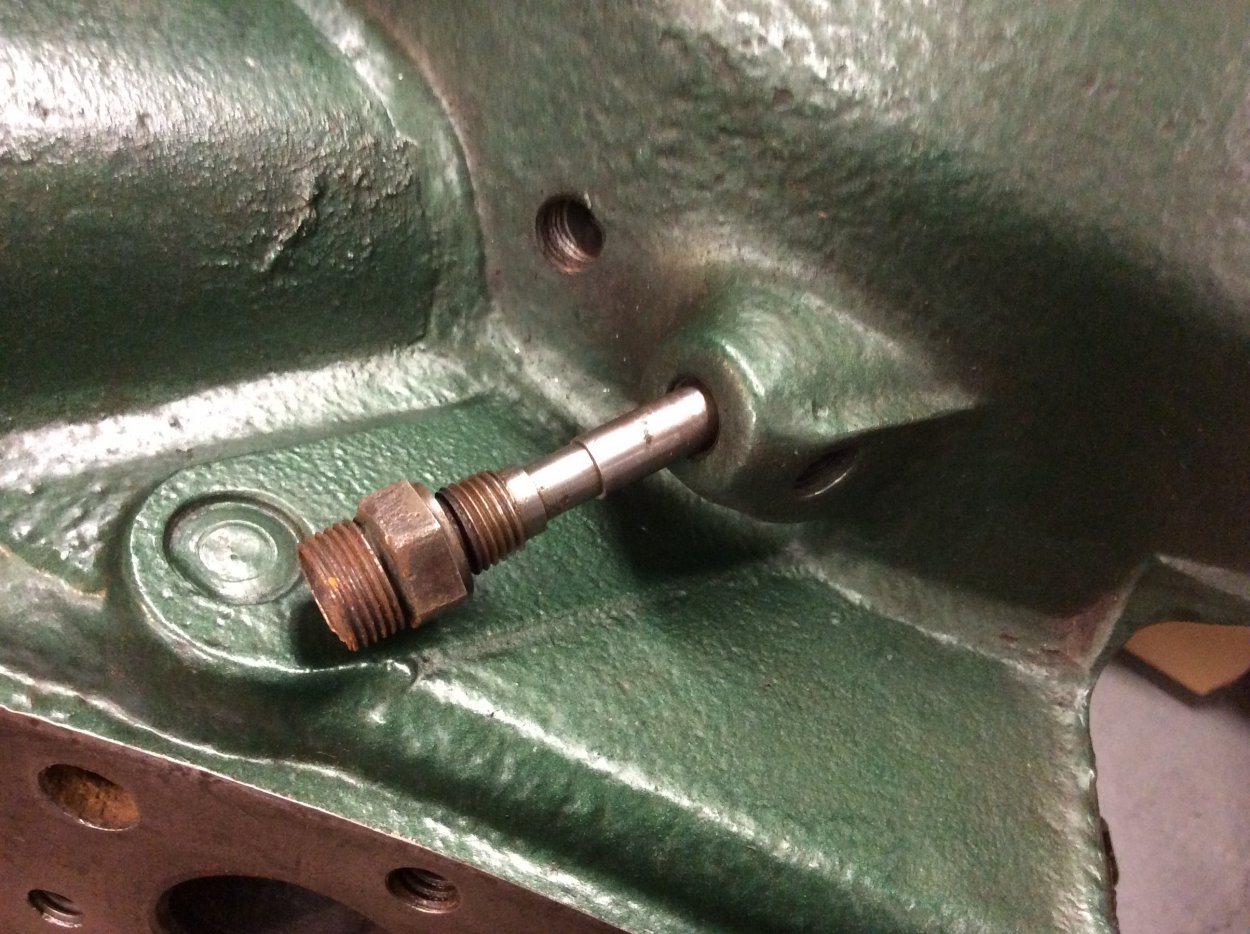

I checked the 1942 Canadian carrier we have. First of all, I should say I got it wrong. I assumed the long fitting was solid. I just found it's not, it's hollow, which completely invalidates what I said above in the deleted post.
Anyway, our carrier has the fitting installed in the outer vertical port, as all the drawings show. There is no grub screw installed in the horizontal passage between the two vertical ports as shown by the "straw" photo below.
I have attached a sketch of the fitting. The tubing extension on it is 3/8" OD, which is a fairly snug fit in the vertical passage coming up from the pump. I would guess diametral clearance as about 1/32" based on how much it moves side-to-side in the passage.
So it directs most of the oil from the pump up into the cooler but also allows some flow through the gap between the tube and the passage wall to the crank brgs, etc. Just as well, as if there was no bypass, I think starting the engine with the engine and cooler drained would cause bearing damage by the time the oil got all the way around the circuit.

Malcolm. I have a couple of those fittings that have an internal taper cut in the end of the tube. (not sure what for)
Alistair, they appear to be made up as per Malcolm's drawing with a tube pressed in or sweated into the enlarged bore of a standard fitting (same as the short fitting in the other hole) This could be made with a current std. fitting. except that they would sit slightly higher because of the extra length in the spanner hex. I have not seen one like yours, before.
When Andrew Rowe spoke about a threaded plug in the horizontal hole, that is because the Australian (LP2/2a)carrier fittings do not have the long tube. They made it a total through flow system (all the oil must go through the cooler or the bypass valve to get to the engine galleries)

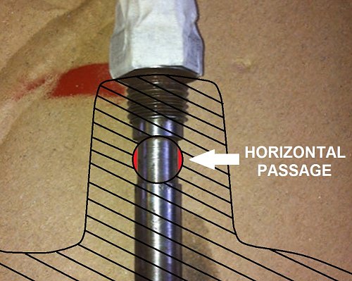

Now that's what I call OPTIMISTIC! Hoping that massively obstructed horizontal passage can pass enough oil to keep the bearings wet, and praying that no tiny morsel of gunk arrives to block it off completely!
Name:	waisted outlet fitting.jpg
I think it's reasonable to assume those tiny red apertures are not intended to flow oil, but merely transmit oil pressure to the port, so that a sensor can be fitted if required (sender switch or capillary pipe). For example British T16 PRV mod discussed a while back:

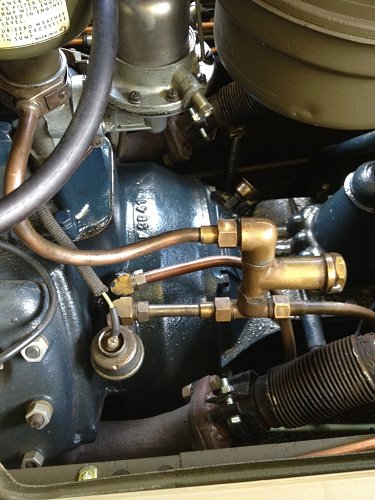

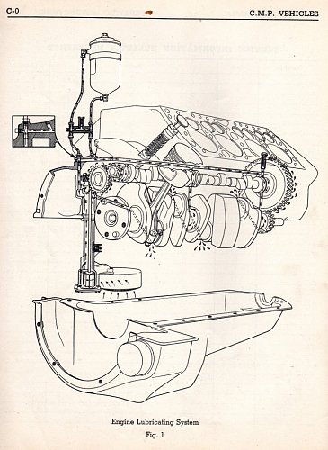

Obviously the only safe route for "full flow" oil cooler return is via the third port found on military spec flatheads (or drilled by hot rodders). Oddly enough the Ford CMP manual depicts "full flow" filtration achieved by means of a waisted bushing. This system has never been found on any vehicle, but the diagram serves to demonstrate the potential application for hot rodders. Hence the screw-in waisted fitting may be an aftermarket product for conversion to "full flow" filtration, without having to drill and tap for a grub screw. As you say Alistair: "the long fitting simply does the same job as the grub screw".
Name:	img146 - Copy.jpg
ID:	80888 Click image for larger version
Name:	img146 - Copy (2) - Copy.jpg

Tony, I assume that the filter assy in the CMP is a bypass filter, not a full flow type? (single centre bolt on lid)
In the carriers there is an unrestricted flow through the cooler and back to the galleries. They are fitted with that type of bypass valve which is supposed to bypass the cooler if the oil is cold and thick.
I am keeping this going because I am not yet 100% sure about how it should be in a full flow situation as opposed to the lesser volumne required for a bypass filter (which probably has a 0.065" restrictor on the line in) It makes more sense to have the cross gallery completely blocked, than have some of the supply head off directly to the rear main.
I guess in the end it just might take one more trip around the circuit before it all goes through (an added full flow) filter.
Yes Lynn, standard bypass filter assembly with return pipe to oil pan. That full flow system described in the Ford manual is a complete mystery to me. Stillborn idea perhaps...?
Yes, it's the same part in the diagram, intended to protect against blocked filter.

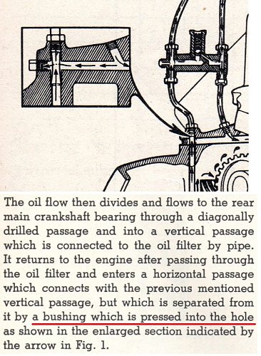

The adapter directs all of the pump discharge oil that reaches that point out of the block, the rear main feed issue is just a Flathead design quirk that they couldn't get around and so had to live with. The problem is that the rear main feed is drilled from a gallery closer to the pump discharge than the tapping on the top of the Bell housing.
Any restriction in flow up to the block mounted PRV doesn't matter at all as the original pump on all British Flatheads has no pressure relief, so the oil velocity will be higher through the restrictions but the volume flow will be maintained. Pressure will increase before the restriction to the limit of the pump gear clearance or mechanical failure.
I'll try and measure the dia of the gallery from the pump up to the top of the Bell Housing, it isn't much larger than the fitting extension tube, I think the clearance is just that, rather than a design intent associated with partial oil bleed off.
The waisting of the tube allows the horizontal Bell housing port to see post cooler / full flow filter oil pressure if you wanted to pop on a sensor. The cross sectional area is just less than half that of the fitting extension tube on my version. I will test all this out with some additional sensors when I finally get the 24 stud in my Loyd.

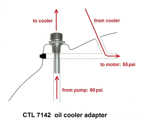

Yes Lynn, it appears you and Malcolm have misunderstood the screw-in adapter. It's not designed to provide bypass flow to the motor. That function is performed by the external bypass valve. As Malcolm says: "The tubing extension on it is 3/8" OD, which is a fairly snug fit in the vertical passage coming up from the pump." In other words, just enough clearance to avoid binding when screwing in and out. Any leakage past the sides would be miniscule, as the pressure differential between the two passages is perhaps 5 psi at most. I believe the bypass valve is set at 10 psi (?) to ensure adequate flow to the motor when cold. Of course, it relies on the cooler being full, as you guys mention.
Name:	CTL7142  oil cooler adapater.jpg
the hole in the adapter would be a restriction (little over 1/4") and much smaller than the main galleries in the block.
The Aussies plugged the cross drilling in the Aussie carriers (in the parts book) but used std fittings without the same sort of flow restriction.
This is one of those counter-intuitive situations where we need to resort to physics. It can be calculated that an adapter of 2" length and 1/4" ID will restrict flow by the same amount as 10" length of 3/8" oil gallery. In other words, it's insignificant. Which begs the question: Why do hot-rod books propose the grub screw method, when the screw-in adapter is so much simpler?
This would be a real trap to someone changing the engine use, and would have caused a few "run" rear mains.
Actually it's the forward bearings which would fail, as the rear main is supplied direct from the pump. Not that it particularly matters! As you say Lynn I'm sure this trap led to catastrophic failures upon engine swap. Again, it begs the question: Why would Aussies booby trap their carrier motors in this way?
