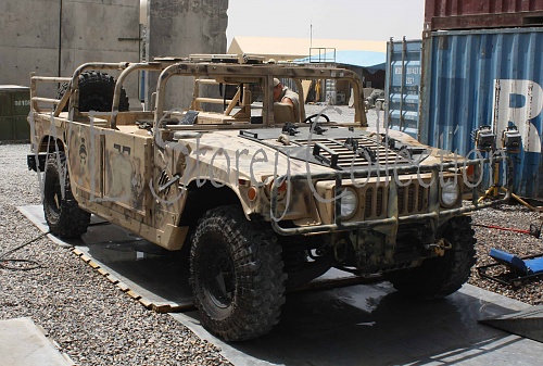

I managed to get a photograph of this Canadian M1025A2 at the washrack in Kandahar in 2011.
